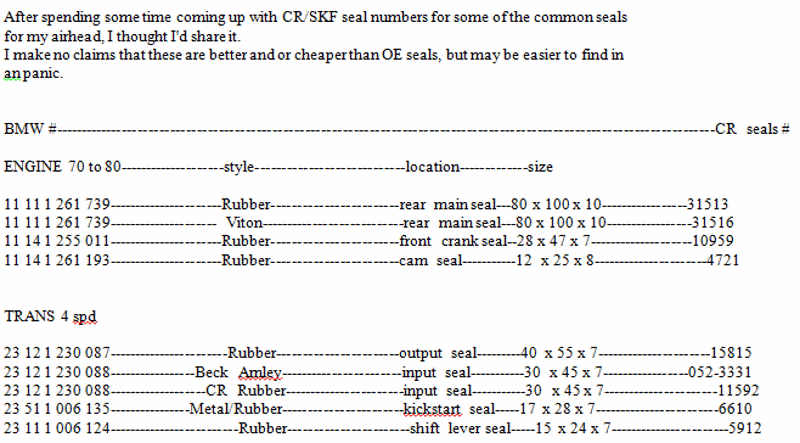

Doesn't include wheel bearings but having found it, someone posted this with skf seal numbers many years ago.
