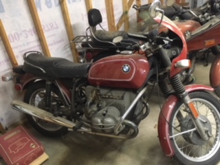

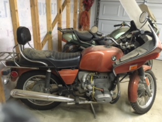

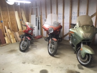

Here are the bikes. I also got about 5 boxes of parts that I have to go through.
- IMG_0168.JPG (38.4 KiB) Viewed 1608 times
- IMG_0167.JPG (40.16 KiB) Viewed 1608 times
- IMG_0181.JPG (34.07 KiB) Viewed 1608 times
