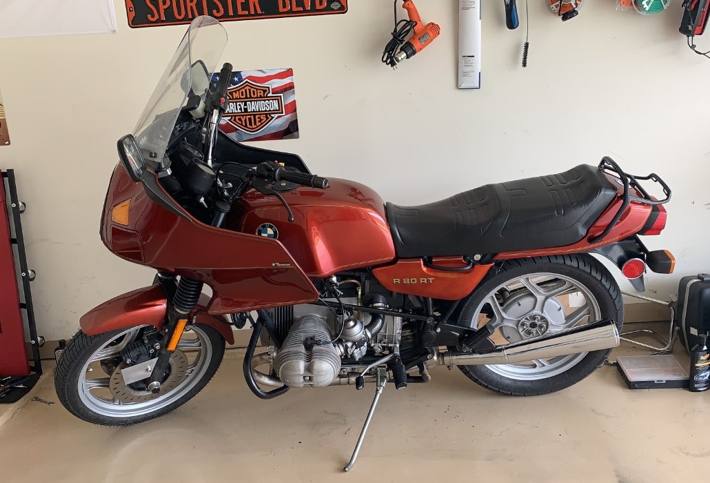

Hi there, I am new to this forum and need your help with advice.
Bike starts and after 10 seconds it dies. I must wait hours to start it again and works fine.
I replaced spark plugs, cables, ignition module, ignition coil, diode. It worked fine for a while but now, I am feeling frustrated with the same problem now that is cold over here.
I thought about the hall sensor, but I want to have input for some more wise than me people.
I really appreciate your time to this matter.
Stay and ride safe. Hope the pandemic is not that harsh on you all.
Regards.
