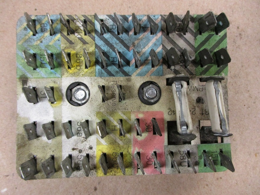

you should be getting some voltage on the brown/yellow wire with the ignition on, IN GEAR (no neutral light, and the bike has the problem that it won't start), and the clutch pulled in (a needle pierced into the insulation connected to the red lead from your multi meter and the black wire connected to a ground). From the simplified drawing from Rob, power ONLY goes to the clutch switch when the ignition is on and the starter button is pressed. I may not be full 12v as it's going through the relay which adds resistance.
If you don't have power there, you have to trace that brown/yellow wire back to where it gets to the starter button. It may (probably?) go into that bundle of wires you saw in the headlight and connect into the fuse block.
I got this picture off Ebay.
Note the 2 pins on the second row, pins 3 and 4 marked "85b"
I believe this is where the "hot" side of the clutch switch attaches. The second pin in that pair should come from the starter button, as per Rob's drawing. It should get voltage when the starter button is pressed (ignition on).
FYI, but since the starter button functions, this is not a problem, the blue/yellow pair of pins (1 and 2, top row) marked "85". That come from the Starter Relay and go to the Starter button (as per Rob's drawing).
The point being, BMW does not seem to wire things "point-to-point", but instead makes a number of these connections in the "fuse block". They do a pretty good job color coding and numbering in the fuse block for you to follow.
Feel free to PM me if you have additional questions. Hope this helps.
