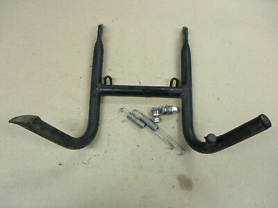

As far as airheads go, the sidestands are all total crap, user beware, and the center stands aren't much better. The later GS airhead centerstand has the lower parts splayed out about 45 degrees which somewhat enhances stability on mushy stuff. Not sure if it will retro-fit other models.
gs stand.jpg (17.45 KiB) Viewed 847 times

gspd wrote: Mon May 10, 2021 11:52 am As far as airheads go, the sidestands are all total crap, user beware, and the center stands aren't much better. The later GS airhead centerstand has the lower parts splayed out about 45 degrees which somewhat enhances stability on mushy stuff. Not sure if it will retro-fit other models.
I'd like to see about retrofitting one of the newer, wider-stance center stands onto my '80 r100t/7. They seem a little better suited for a wider range of terrains.
Fortunately, I only ever have had to mount up the bike on asphalt and cement, and never in temps higher than ~85° Fahrenheit.
For now, the center stand is doing its job, even if the "foot catch" that is used to pull it down is broken off and only a nub of it remains, it's enough to manipulate while I'm off the bike. There's a solid handle mounted on the left side of the seat (just forward of the seat release button and lock) that allows me the leverage needed to get the bike up and down. I have yet to have an issue with the stand so long as I'm manipulating it from the left side of the bike while not mounted.
