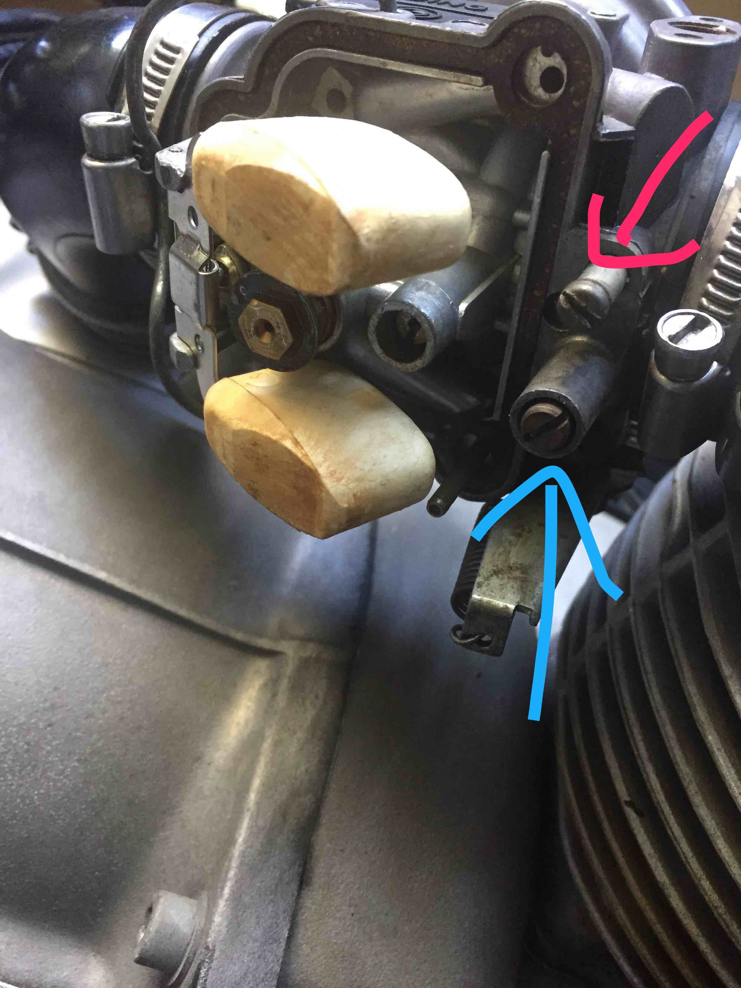

Another question. Something that has confused me since I started in on the carbs, on the attached photo, the blue arrow points to the mix screw. The red arrow should be the idle stop screw? This screw has absolutely no adjustment to it. If loosened at all it is wobbly in the threads and I'm sure would just rattle out. It seems to have no effect on how the carb runs. The diagrams Clymer gives have a different looking screw with a spring assembly of some sort, but they are using a slightly different model of carb I think. Thoughts?

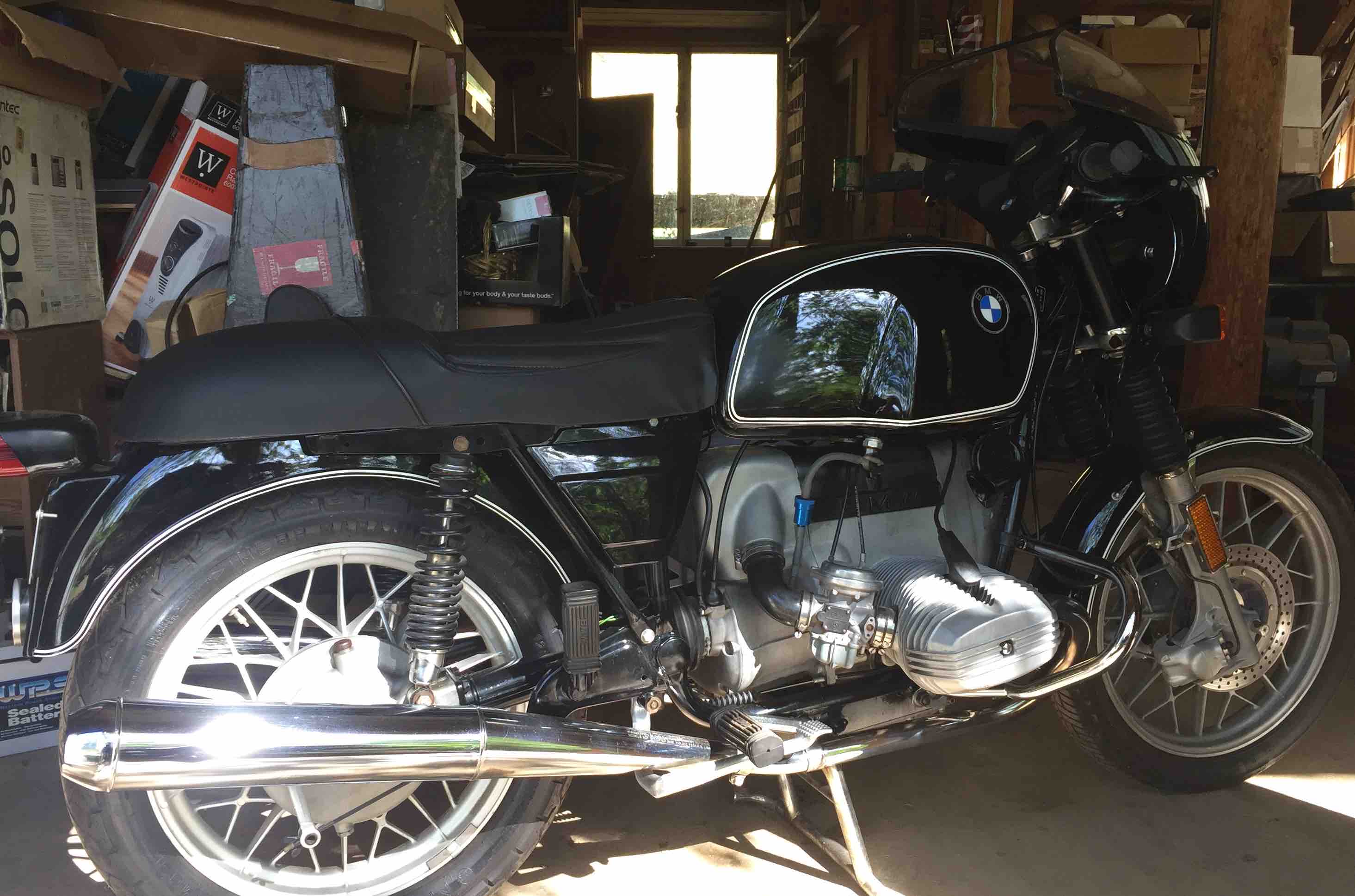

Also, for fun, here's a photo of the bike from this morning:
- IMG_4231a.jpg (245.71 KiB) Viewed 3142 times

The red arrow points to the vacuum take off of point for balancing the carbs.
The throttle stop screw can be seen on the inside close to the throttle cable with the adjusting screw pointing upwards.
Your carbs are known as "flat tops" but all the adjusting screws etc are in the same place as a "dome top" carb.

The throttle adjust screw doesn't look anything like my "non flat top" carbs on my '78 R100/7. Are you showing a type 94 carb? I see from the Bing manual that what you show was for the type 94, 64-2 (flat top), and 64-3 carbs. Were they that different on the flat tops? My /7 has the throttle adjust screw access from the bottom...AFAIK it's just a type 64.
Hmmm...might have answered my own question!!

Kurt,
My flat tops have throttle stop adjustment screws pointing upwards.
Yes it was a picture of a 94 carb and just the first thing I found that showed the throttle stop screw on the inside with screw upwards.
Re: Carb Issues
The carb Barry shows is from a R100S.
Looking at the OP's pic, I think his throttle adjust screw should be the same because I can see the throttle arm behind the air mix screw.
Re: Carb Issues
Hey guys - throttle adjust screw is on the bottom - I was right about that one. I was confused about the idle stop - it is at the end of the cable linkage (duh!) on the inside (engine side) of the carb facing upwards. I have the 32mm flattop.
