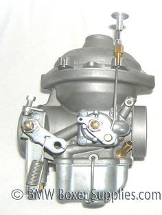

I converted my left carb to something like this, took away the cable on the rhs. Find it starts well with only one side enriched.
choke conversion.jpg (13.03 KiB) Viewed 4956 times

hal wrote: Mon Mar 12, 2018 7:57 am I converted my left carb to something like this, took away the cable on the rhs. Find it starts well with only one side enriched.
+1
Best mod to any CV Bing-equipped airhead.

I like that but I would still do both carbs. No point making the poor engine run on one cylinder until the other one decides to fire up too.

I did both carbs, making ringtopped pulls out of old bicycle spokes. The right one I usually turn off before I even move--maybe 10 seconds on that side. The left one gets turned off right after I hit second gear.
