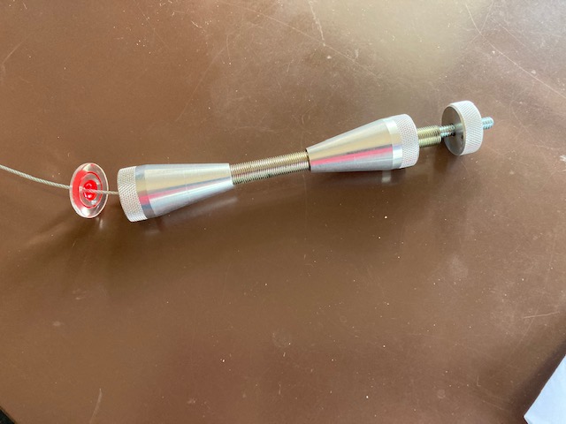

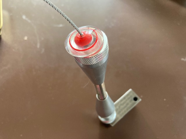

I too have been figuring out how to position the tire on the rim so that they are in better balance with each other. When I do auto tires I position the tire/rim relation on the balancer till I get the bubble to almost center before I inflate and add weights. Doing so on a wire airhead wheel with a tube is a pain. I did find a product from: accessory 034--$38.00--wheel balancer Bench Mark Works LLC Exclusive that is a target balancer that is suspended from a rafter or a point above the wheel. It goes through the axel and is attached so that the wheels is suspended and one can get a reading. Sorry to say that Bench Mark has few pictures of products on their site. So I took some to clarify the design. The object is to get the bulls eye striped disk to center on the top portion of the the cone in the axle.
I haven't messed with the product yet as the tires on my airhead are balanced and I haven't had to change rubber yet
- Balancer2.jpg (47 KiB) Viewed 1797 times
- Balancer1.jpg (61.14 KiB) Viewed 1797 times

jagarra said: "The object is to get the bulls eye striped disk to center on the top portion of the the cone in the axle."
I wouldn't expect any degree of precision with that setup.
But then....
What degree of accuracy is actually required?
I anally strive for (almost) perfection when balancing my wheels, and like to get down to 1/4 oz + or - , but I also know that in the real world, a 1/2 oz imbalance is imperceptible.
