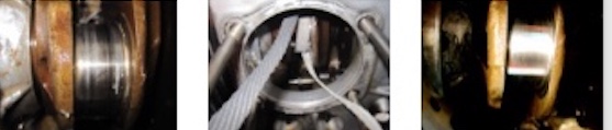

knock knock.jpeg (54.38 KiB) Viewed 1575 times
Re: knock, knock, who's there?
gspd wrote: Thu Jun 16, 2022 7:25 pm Can't say 1000%, but my experienced ears would bet ($100?) that the knock in the video IS a big end bearing knock, nothing else sounds like that. Even on shitty computer speakers. Only an autopsy will confirm that.
Please elaborate....Where did you get this info????
Stock type 247 crankpins are all the exact same size and there are only 4 sizes of shells available:
1 - stock
2 - .25 over
3 - .50 over
4 - .75 over
Obviously you need a total of four shells, two per connecting rod.
You're right, I was misreading the data for the main bearings... not that it makes a lot of difference, 4 or 16, you still need to know which to buy.
The depth of the damage to the crank, hence the amount of material that has to be removed, determines the oversize needed, not the amount of times it is reground
OK, I accept that point but it is normal to refer to them as a 1st stage to 3rd stage regrind, I just omitted the word 'stage'... again, I don't see that it makes much difference to the point, which is that you can't order big end shells before you know the state of the crankpins.
It is perfectly possible to regrind an airhead crank and have it give satisfactory service provided it is done by an expert engine rebuild service with the necessary equipment. I acknowledge, though, that many are not done well and can fail. A 'proper job' will be expensive and good second hand used cranks are probably a better bet...
[/quote]
Rob Frankham wrote: Fri Jun 17, 2022 8:46 am You're right, I was misreading the data for the main bearings...
I always knew that deep down you had a human side :lol:
Rob Frankham wrote: Fri Jun 17, 2022 8:46 am you still need to know which to buy.....which is that you can't order big end shells before you know the state of the crankpins.
All you can do is order the stock shells and cross your fingers that the crank is only slightly blued and will hand polish up satisfactorily. You do the polishing with compound and a shoelace and hope for the best. No amount of polishing will reduce the crankpin O.D. enough to fit even the smallest oversize shells available; that would require a crank regrind. You won't remove too much material from the hardened surface by polishing. As far as measuring things, forget it. Measuring any used crank is an exercise in futility. If you precisely utilize the best measuring tools, you'll soon realize that every used crankshaft in the world is out of round and out of spec to a certain degree. That doesn't mean it won't work 'virtually' forever. Precise measuring is only required during and after regrinding to correctly purchase and fit the new shells and bearings.

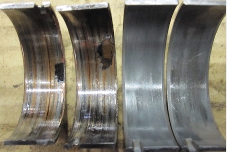

before and after.jpeg (25.64 KiB) Viewed 1538 times
Rob Frankham wrote: Fri Jun 17, 2022 8:46 am It is perfectly possible to regrind an airhead crank and have it give satisfactory service provided it is done by an expert engine rebuild service with the necessary equipment. I acknowledge, though, that many are not done well and can fail. A 'proper job' will be expensive and good second hand used cranks are probably a better bet...
Can you provide a link to one of these 'experts'? I can't find one, and god knows I've tried. This is an extremely specialized job and needs a very special machine and/or a very unique setup of a conventional machine. The short airhead crank won't fit any commercially available crank grinding machine currently in production. Theoretically an extension could be fabricated to extend the crank and make it fit but that would be very costly and somewhat imprecise. The oversize shell fiche listings don't really apply to airheads, they are remnants from the older BMW automotive parts fiche. Back then, (some) BMW cars used the same shells as our airheads. Pretty well anybody with a standard crank grinding machine can successfully regrind a BMW car crankshaft.
The main obstacle is that BMW type 247 airhead cranks are a one piece forging. Don't confuse them with /2 and most British motorcycle cranks that can be pressed apart, fitted with new journals and pressed back together. This is also a very specialized job, but tons of shops do it.
