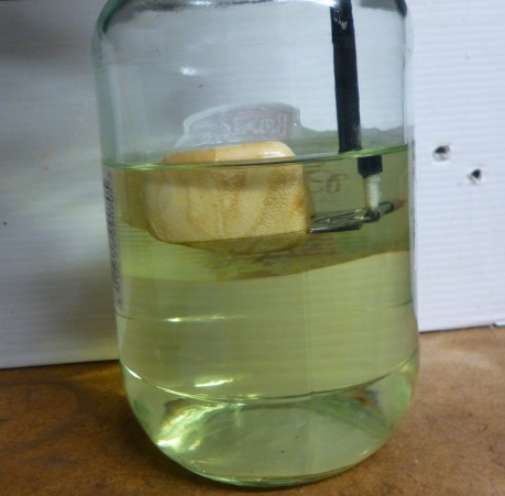

Ongoing saga. I cleaned up the bike today to give it a test ride. Turned on the gas and big time leak from that same carb. I took off the bowl and pushed up the floats and the leak stopped. I now have it off the bike and the floats go with me to work tomorrow to be weighed.
I do realize that when I pushed up on the floats it probably put more pressure on the seat that shuts off the fuel. If it's not the floats causing the problem, well..............? They seem very light. Will weigh them.

The rubber on the tip of the needle can harden.
Re: Carb question
You could also try a float test. This is one of my sinkers at 16 or 17 grams. There should be be more like one third of the float above the surface. The float is suspended by the pivot as it is when mounted in the carb. If I didn't support the pivot end the float sank to the bottom of the jar.
Float test.jpg (63.79 KiB) Viewed 2042 times
