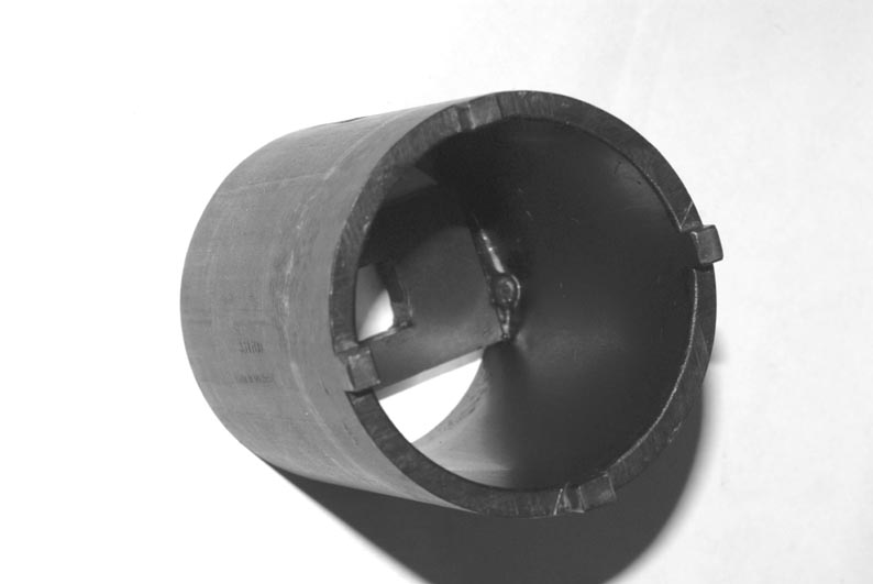

One of the benefits of being a member of the BMW Club here in the UK is loan access to all the Special Tools the Club has. Currently I'm doing some Final Drive work and have the Threaded Ring tool sitting (almost) next to me. This is what it looks like:
As you perhaps may see, it's (like many of the other "special" tools) not very complicated. As for dimensions, I'd be happy to provide some measurements, but those can easily be taken from the FD itself.

Apparently Cycle Works doesn't sell a /5 specific tool. You have to buy a /2 tool and a set of pins, and the big socket, for it to work on a /5; http://www.cycleworks.net/index.php?mai ... l&x=17&y=4
