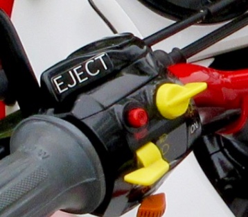

While you're at it, you might want to add one of these. It keeps 'em on their best behaviour. :lol:

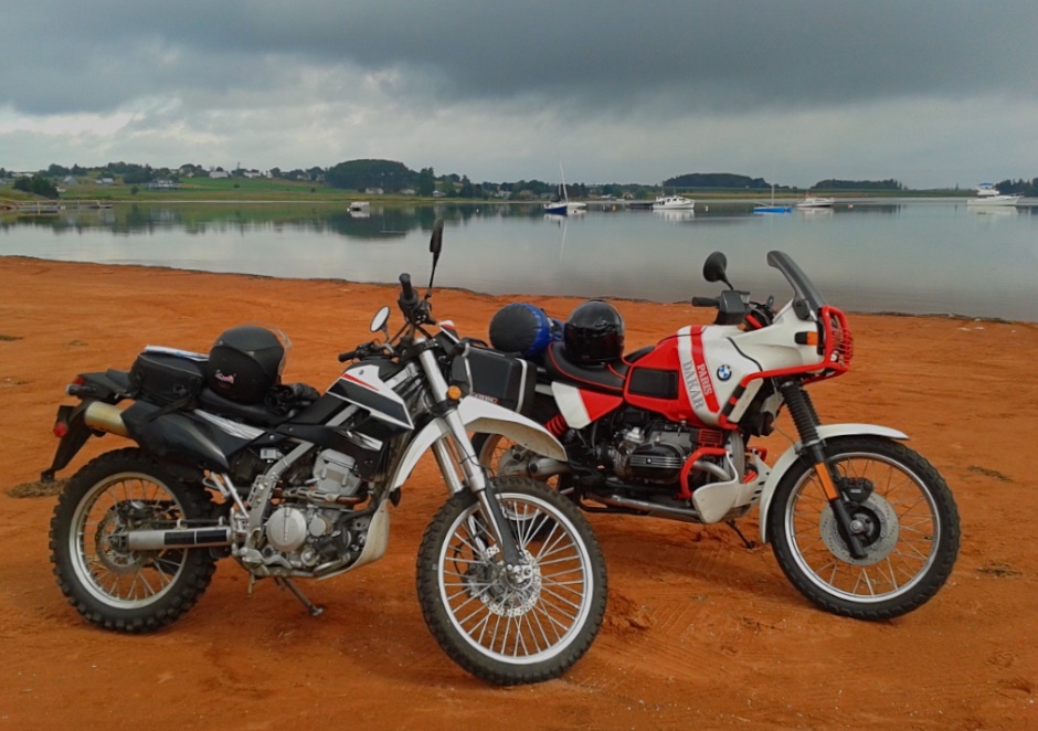

Now we travel all over together: :D
I must be a good teacher: only 4 (minor) crashes and one speeding ticket (130k in a 100k zone) in her first 80,000km solo riding. :oops:
