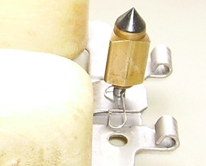

I've never heard anyone do what you have described on any of the airhead forums over the last 17 years. While it may be technically possible to fit a screw adjustment, I wonder if it's a little over the top but I do like the precision approach. I'm not familiar with the detail of those slide carbs but the CV carbs have a wire clip that loops around the tab and through the hole in the float needle pin. The idea is that when the float falls it will positively pull the float needle off it's seat. An adjustment screw would preclude the use of that clip.
Although it's not quite correctly positioned in the pic below it shows the clip I'm talking about.
Float Needle Clip.JPG (74.22 KiB) Viewed 2516 times

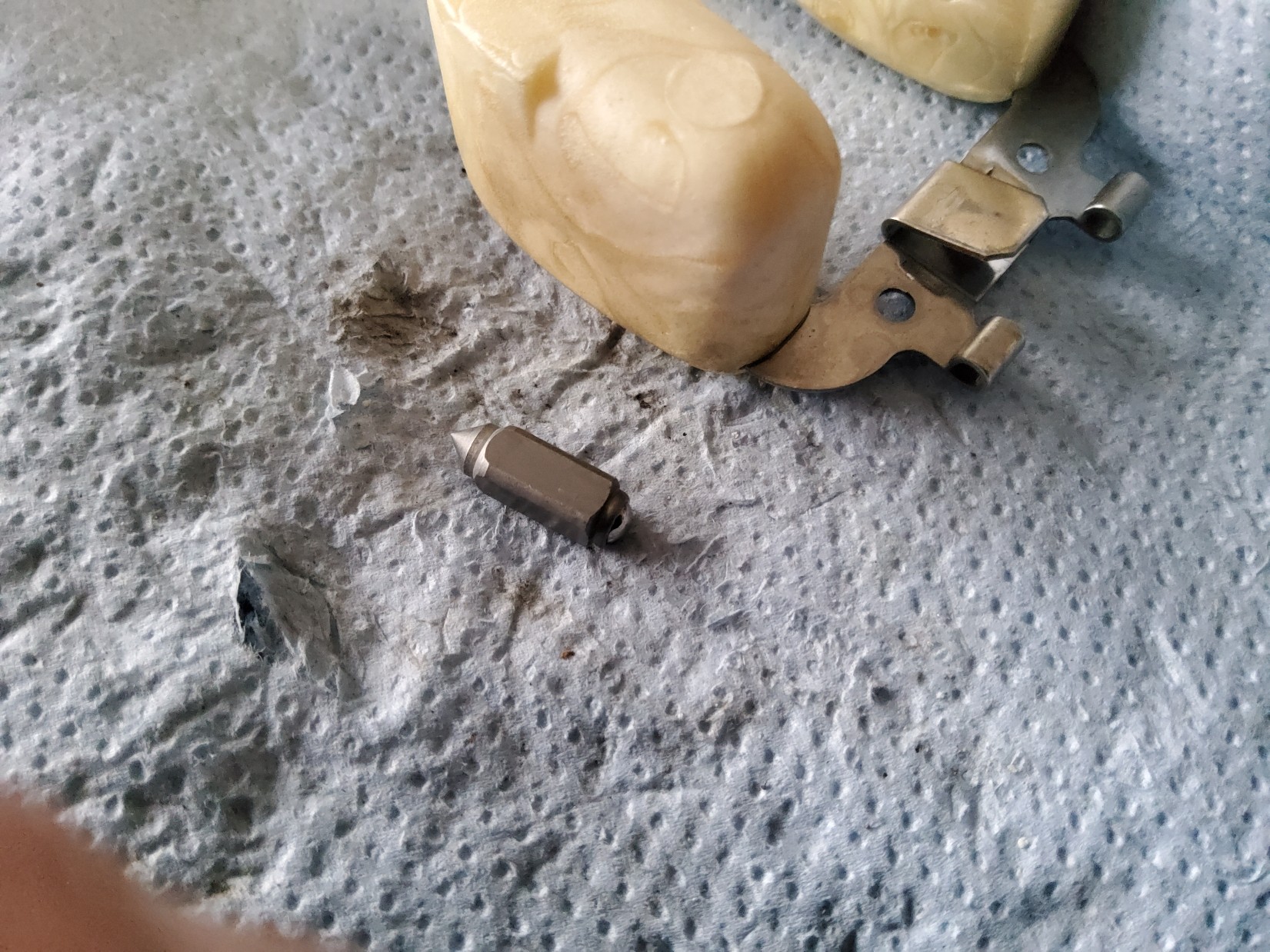

Thanks Barry, the float needle on mine is quite different, with a spring loaded ball end. Hang on, I'll try to get a pic.....
Re: Float adjustment
Posted: Thu Mar 21, 2024 12:47 pm
by Chris in Frome
Posted: Thu Mar 21, 2024 1:02 pm
by Chris in Frome
You can see the tab has quite an angle on it, I've now ignored any depth dimensions and am using the parallel method

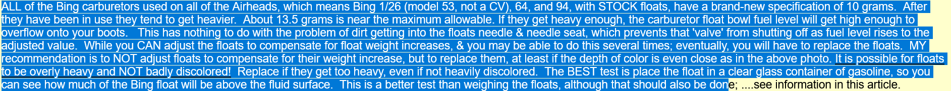

Posted: Sat Mar 23, 2024 8:06 pm
by SteveD
Screenshot 2024-03-24 at 11-01-30 Bing Carburetor floats on BMW Airhead Motorcycles.png
Screenshot 2024-03-24 at 11-01-30 Bing Carburetor floats on BMW Airhead Motorcycles.png (86.31 KiB) Viewed 2440 times
Snowbum says new floats on all Bings are 10gm.
He also says 13.5gm is likely "maximum allowable". Ongoing adjustment might extend their usefulness, they'll need replacing eventually.
https://bmwmotorcycletech.info/bing-floats.htm
Re: Bing float weight
Posted: Sun Mar 24, 2024 5:14 am
by barryh
SteveD wrote: Sat Mar 23, 2024 8:06 pm Screenshot 2024-03-24 at 11-01-30 Bing Carburetor floats on BMW Airhead Motorcycles.pngSnowbum says new floats on all Bings are 10gm.
I hesitate to disagree with Snowbum but that's not been my experience at all.
It was my understanding that some floats were at one time 10 grams but that is no longer the case.
I weighed new floats supplied by Motobins with a certified lab scale and they weighed 12.495 grams. My experience before replacing the old floats was they will function perfectly well at 13.5 grams or more provided you lower the adjustment by 1mm per extra gram. By 14.5 grams you should be replacing them. The one old float that became a sinker and caused flooding was more like 16 grams.
It seems very unlikely to me that floats available today would weigh exactly the same as they did 45 years ago so I'm not surprised to see some difference but 25% heavier doesn't seem right.
The only realistic way forward is for people to weigh new floats when they get them which establishes a benchmark for future reference.
