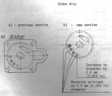

Don't expect the chokes (enrichers) to work flawlessly on 79 flatops. They can be OK for a cold start but not much use when the engine is running. If yours haven't already been done there was a service bulletin modification which makes them work better either by replacing the disc with a later type or modifying the existing one to drill a 4th fuel hole and to enlarge the counterbores on each of the 4 holes. It's a tricky job though involving a 0.6mm drill bit that is so small you can hardly see it. Made a huge difference to my enrichers so highly recommended if it needs doing.
Enricher disc mod.png (103.22 KiB) Viewed 1225 times
