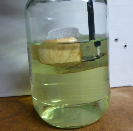

gspd wrote: Thu Sep 23, 2021 5:11 pm I've also seen heavy saturated floats lighten up again after being left lying around for a while (many months?) .
I still have my old sinkers and after years on the shelf they did lighten but not back to the new weight of 12.5 grams. I no longer have access to accurate lab quality scales but I think they are 13 - 14 grams which is certainly usable in a pinch. They never were dark brown more like light tan - see pic below.
Kurt in S.A. wrote: Thu Sep 23, 2021 1:18 pm Oak always suggested putting the floats into a container of gas. If 1/3 of the float was above the gas line, the float was generally OK. I think Snowbum did some float-weight testing years ago...might have posted about it on his website.
Chucking them in a jar of fuel to see if they float doesn't replicate how they work. I reasoned that you need to support the pivot point in some way. The 1/3 above sounds correct because these floats were around 16 grams and close to sinkers. Without supporting the pivot point they sank like a stone.
Float test.jpg (63.79 KiB) Viewed 1108 times
