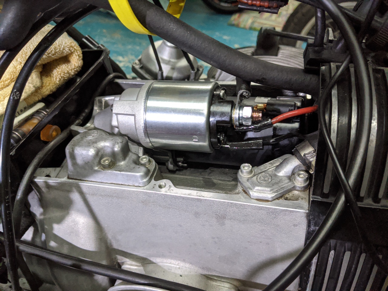

Installed the new starter today and all seems well. No intermittent starting. I never found anything interfering with the install as far as the crankcase casting is concerned. The gear reduction starter is obviously using a lot less amperage. After about 20 tries, with spark plugs in, my new battery is still at 98% charged! I hope I can get another 37 years out of this starter
Thanx for all your help! I learned a lot about starters. Think I'll take the old one apart, and service it up. Here is a shot, bolted in and wired up
Yes I pushed the cover for the lower connector on.
- PXL_20210216_024540735.jpg (369.88 KiB) Viewed 1516 times

So I'm riding R100S again, and the new cheapo starter works a treat. $115. vs $650 from the stealer. Starts are effortless, and feel like much less draw, no doubt due to the gear reduction design (planetary gears) of the new Valeo type starter. Because I have a real motorcycle, (AKA one with a kick start) I really don't have to worry if the starter fails. Important.... as I ride in remote areas.
