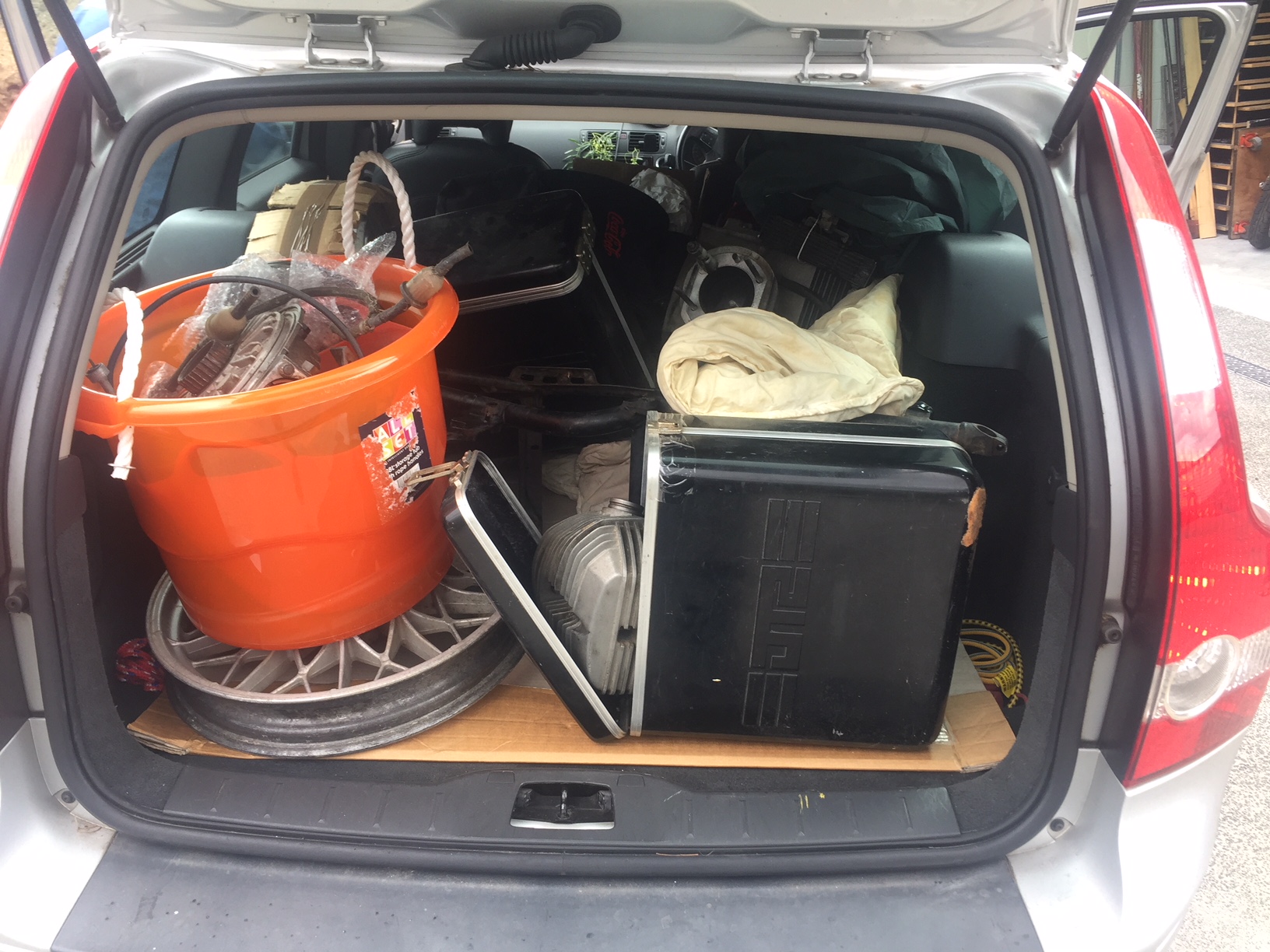

Ahh yes, but you're a mechanic, from hell.
I'm (was) an ICU Nurse...the machinations aren't quite the same. ;) :D
Expertise isn't uniform just because interests are similar. That's why forums are useful. :lol:
Here's the bike that spare crank was pulled from ;) It's in there somewhere.
