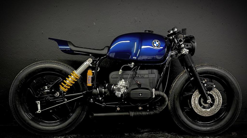

Thank you Barry, much appreciated.
Test ridden and everything is working perfectly.
Until next time, sincere thanks. Alistair.
(Just thought I'd post an image of the bike to show you all what the fuss was about!)
- WhatsApp Image 2024-06-20 at 20.18.37_3d16a178.jpg (73.31 KiB) Viewed 3521 times
