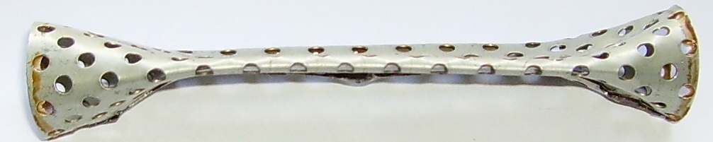

Hope the filter is not like this although you will have used a bendy.
Crushed Filter3.jpg (68.32 KiB) Viewed 2075 times

Bendy filter in there, Barry.
