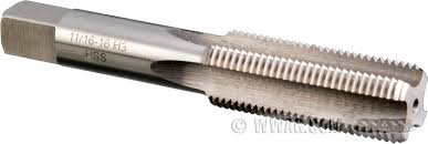

I abandoned that idea due to the difficulty of getting the new thread all the way to the bottom of the cavity.
Maybe a flat ended tap (bottoming tap) would work.
If there's enough meat around the original hole, you could use a helicoil or case saver type threaded insert and reinstall the OE ball and spring in it.
Re: So I permanantly blocked my oil filter bypass
Even a bottoming tap would need to be ground to make it an absolute bottoming tap. I need to get every millimetre possible threaded to keep the cavity as deep as possible.
I made a tap from a hardened and lengthened bolt but gave up on it realising that a proper tap was the only way.
I need to maintain the existing cavity diameter in order for the oe ball to work.
There is almost nothing left of the spring seat in the cavity as the ball thrashing around in there stuffed it.
There is very little meat between the end of the bypass cavity, and the oil gallery immediately behind.
I initially thought a washer could be put in the cavity to make a new seat, but there is nothing left to support the washer in the correct position.
So the spring may not sit properly and the problem would reoccur.
Onwards.

ME 109 , if you can't get the hole threaded all the way to the bottom, just grind the last few threads off of what you will be threading into the hole.
Smile it's contagious!
'85 R80RT wreck for parts
George Ryals wrote: Thu Aug 09, 2018 2:43 pm ME 109 , if you can't get the hole threaded all the way to the bottom, just grind the last few threads off of what you will be threading into the hole.
Gidday George, good to see you back!
This 'Piece' of neutral switch that I've identified as having the ideal dimensions to make a new seat will only be perhaps 3.5mm long. If you look at the threaded end of a neutral switch where the plunger pokes out, this is the end that I'd turn said 3.5mm from. What that would give me is something similar looking to the oe ball and spring retainer. I also though I could use an oe retainer for a new seat and screw it all the way to the bottom of the bypass cavity. The only thing stopping me from using the oe retainer is that it's made from ally, so possibly too soft to support the spring long term?
The brass neutral switch has the same thread, 12 x 1.5
So whatever I screw in there as a new seat will reduce the length of the bypass cavity by whatever the length the new seat is. If I'm to use this idea, I need every bit of bypass cavity 'length' in order to use the oe 8mm ball, retainer and shortened spring. That's why getting the thread and new seat 'bottomed' in the cavity, is important.
It's difficult to get a good look at the condition of the bypass cavity 'wall' and its ability to take a thread. It's been banged around a bit in there, and I wasn't overly filled with confidence by what I could see.
