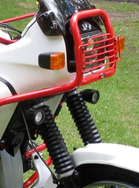

I'm a little troubled about putting shiny parts on a Patina bike, but I've been very very happy with the set I put on Ernst. As Edgar still has stock headlight wiring, I put the wiring in the headlight shell. BMW had spare ground spades and an extra high beam spade already on the junction board in the headlight shell. I had to piggyback on the low beam. As before, the wiring is not DIN colored, with black for ground, red for low beam and yellow for high beam. So not DIN, but Schwartz/Rot/Gold like the German flag. Kinda. The kit comes with each light wired separately. I combined the harnesses so there are only three female spade terminals. Here's a close up of the spaghetti mess:
The blue jacketed terminals are from the fairing harness and while I was initially suspicious they are actually well done and I'll be leaving them.
Here they are mounted, not lit:
If I had lit them, they would have hurt my camera. These things are bright!

Did you mount the lights to the lower fork legs???
Re: Idiot v. Motorbikes, Rounds 3, 4, and 5
gspd wrote: Mon Sep 27, 2021 8:25 pm Did you mount the lights to the lower fork legs???
Yes. Seems a natural.
Unsolicited, I had an FJR rider (and also Airheadist) catch up to me at a gas stop last summer to tell me "Those things filled my mirrors!" This was on Ernst, fork mounted. They're pretty light, maybe not much more than that steel bottom cap, so I'm not concerned about unsprung weight.

melville wrote: Mon Sep 27, 2021 9:28 pm
I always wanted needed aux lights that steered with my forks (mainly because my main headlight is fairing mounted and doesn't).
I had initially mounted some to my lower fork legs.
The beam was annoyingly 'bouncy' for lack of a better word, especially on bad roads.
Moving them up to the lower triple clamps really steadied them. Much more relaxed lighting.
The less unsprung weight thing was a bonus.
