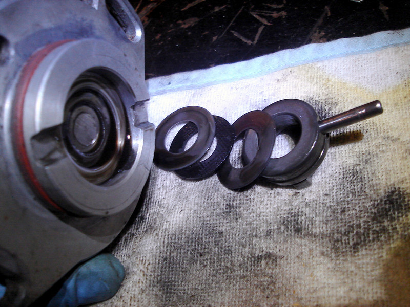

Many years ago I found a little oil in my points bean can. I suspect it was as much to do with excessive crankcase pressure I had at the time and has since resolved itself. The O ring has nothing to do with keeping oil from getting inside the can. Any oil inside the can will have got past the drive shaft. There are a series of washers at the back of the can which may be intended as a crude oil seal of sorts.
Not a pic of my can but it was the same.
- Bean Can 2.jpg (163.52 KiB) Viewed 1064 times
Re: '79 bean can with significant oil inside it. Boyer Ign add.
How do you take apart that rear of the bean Can to access those washers? I tinkered with it for a while and couldn't figure it out. I'd like to inspect and clean it out...
It sure looks like a Bosch VW distributor in that area. See the pin that's been knocked out of the dog ring? See if you can get access to that with a thin punch, possibly through the notches in the body.
- Posts: 1342
It's quite tricky... you need to drive the pin out and it is quite tight. The first thing to do is to remove the spring , This can be pulled off and out of the way with a small screwdriver (or similar). Looks more difficult than it is. You then need to support the drive dog in such a way that you can use a drift to drive the pin through... the recesses in the bottom of the can flange are there so you can get access. At the same time you need to support the body of the can so itself doesn't move around. A three handed job if ever there was one. Every time I do it, I swear I'll make up a jig to hold and support everything but I haven't got round to doing it yet. The pin needs to be hardened steel and the best I've found is as suitable sized masonry nail with the point ground off... mild steel will just distort.When all's said and done, it's fiddly but do-able.
