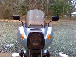

I have these on my 77RS
http://www.discount-motorcycle-parts.ne ... -1674.html
I bought a second set of mounts because I always want to go back to stock.
Note these mounts are black and the stock ones are the paint color.
Had to drill them out, as the mirror mounts are 10mm.
Drill slowly, as the heat melts the plastic mount and the thread insert can spin.
After drilling them out, I inserted a 10mm nut from underneath. Tapping the original insert would be better.
At higher speeds (around 80mph) they flutter a bit. Below that, they are reasonably stable.
Sometimes, the one on the left gets loose because of the wind pushing on it.
All in all, I'm happy with the mirror swap. I can see behind me very well.
