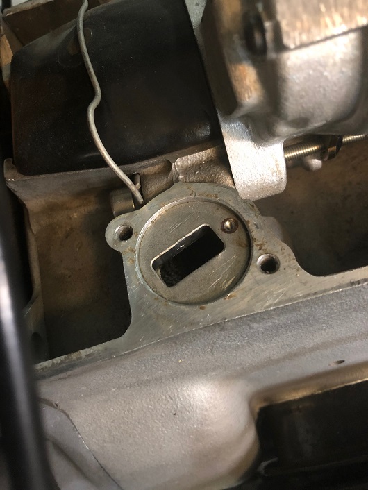

A few years ago I installed the updated reed breather valve in my '74 R90s as the stock disc was making the turkey gobble.
Come to find out I need to orient it to point to the 11 o'clock position when sitting on the bike. Of course, I installed it pointing at the 4 o'clock position.
Can someone suggest a tool to pull it out so I can rotate it?
See attached photo (note, I've removed the reed itself and cover).

A little heat around the edges of the case might provide enough expansion to let the valve come out. As for removing, I would think the way you removed the original breather might work here...my old one didn't want to come out. I was able to wrap some wires/steel cable around the webs of the old one and use a slide hammer effect to jerk it up and out. I realize there's nothing obvious to grab on to, but something that you can slip in, a small plate, a high strength bolt, tool steel, and then turn 90 degrees could be used to bear against the underside of the valve. Be careful that nothing can drop into the hole. Then grabbing that tool with some wire, etc., use a slide hammer to provide some momentum to pull it up.

I heard the same thing about orientation...Tom Cutter was the one who mentioned on the Airhead email list...I believe Snowbum states it also on his website. My understanding is that it orients the outlet to more in line with the hoses, etc., for extracting the oil mist. If the breather releases the mist and it has to turn 180 degrees to head out, that's just a restriction in the flow. Couldn't hurt I suppose to streamline the flow of oil mist.
If your reference information was written only at the time of the older style breather, it would have nothing about orientation of the reed style. The picture in my Haynes actually shows the reed valve oriented the "right" way...the screw holding the metal tab is pointing towards the rear of the right cylinder.

As it turns out, the open slot is 3/8", which means a 3/8" socket extension fits perfectly. Per Kurt's recommendation, I applied some heat with a gun and used a long handled 3/8" drive torque wrench to rotate it to it's correct position. Didn't even have to remove it.

If the issue is with aligning the reed with the outlet hose... and I really don't think it would make any difference but never mind... then the reed should be aligned facing aft... i.e. at the 06:00 position for the early machines. Late machines, the ones fitted with reed valves as standard, have a different arrangement, with the ejected air passing forward from the valve towards the front of the engine where it is picked up by a longer hose. for these machines the reed pointed at 11:00 might make a little sense. In other words, you have just moved your valve from a position few degrees from where it should be to a position nearly 180 degrees away from it.
Attached two screen dumps from the BMW parts system to illustrate the difference between the two breather setups...
If you are really worried about the issue, I would suggest you need to rotate the breather back to an 06:00 position.
Personally, I believe this is just another piece of airhead lore that has no basis in logic or science. The stream of air from the valve will not be particular great or violent and any restriction in flow will be so slight that the result would be negligible. The path in the later engines is, by design, far more tortuous and this doesn't cause any problems.
