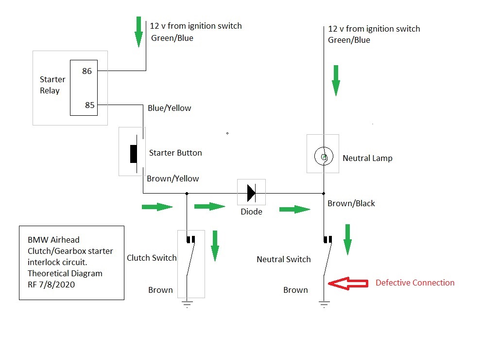

The starter relay (not the solenoid, the relay that is under the tank) takes it's current from the ignition switch via the kill switch. The positive side of the relay will always be at battery voltage when the ignition and kill switches are both on. Control of the relay is by the ground line. The ground side of the relay is connected to the starter button... if the starter button were connected direct to ground, the starter would work every time the button is pressed, even if the bike was in gear and the clutch wasn't pulled. This isn't 'healthy' because - a) engaging the starter against the resistance of a bike in gear isn't going to do the starter any favours and b) because it may result in the engine starting and the bike taking off when the rider isn't ready for it. BMW, therefore incorporated a system which prevents the starter from running unless a) - the bike is out of gear or b) the clutch is pulled. This is done as follows.
The ground side of the starter button is not connected direct to ground. It goes to a diode attached to the rear of the connection board in the headlamp shell. A diode is like a one way valve for electricity... current will flow through it one way but not the other. It then goes on to the clutch switch which is a 'pull to make' switch, that is to say that it carries current only when the clutch lever is pulled. With the clutch pulled, current can flow through the relay, the starter button and the clutch switch to ground which will
activate the starter.
The other end of the diode is connected to the neutral light switch which carries current to ground only when the gearbox is in neutral. When the gearbox is in neutral, current can flow through the relay, the starter button, the diode and the neutral switch to activate the starter.
The result of this circuit is that the starter can only engage when the gearbox is in neutral or when the clutch is pulled (or both of course).
The purpose of the diode is simply to stop the neutral indicator lamp lighting when the clutch is pulled.
Your symptoms imply that the connections as far as the diode in the headlamp shell are correct, that the diode is working and that connections to the neutral switch are OK (otherwise the bike wouldn't start in neutral). The assumption must be that the fault is in the circuit from the diode to groiund via the clutch switch.
I think you are saying that there is no voltage at the switch when the gearbox is in neutral. but that there is all of the time when the a gear is engaged. This suggests that the connection from the diode to the clutch switch is OK as there would be no voltage at all at that point if this connection were broken. That leaves the clutch switch itself and the wire from the clutch switch to ground. Since you say that you have replaced the clutch switch, the assumption has to be that the wire from the clutch switch to ground isn't connecting.
In short, therefore, you need to check the continuity of the Brown wire (with no tracer) from the clutch switch to ground.
At this point, my memory conflicts with the published wiring diagrams. The diagrams suggest that the wire goes direct to the main vehicle ground which is attached to the left coil mounting under the tank. My memory suggests that it actually goes to the ground connection in the headlamp shell. I may be wrong. In any case, I strongly believe that you will find the fault in that connection.
I attach a simplified wiring diagram of the starter circuit with the point that I expect to be at fault marked in red.
I don't know how familiar you are with electric control circuits so I have given as much information as I can. This has led to a long and detailed post and, If I am telling you things you already know, I apologise in advance
NB for others reading this post, the circuit discribed does not apply to all airheads. In particular, the /5 series circuit is very different. Other model years may have detail differences.
R

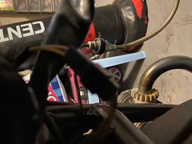

Guys I really appreciate all your responses. I will definitely check the ground that Rob refers to. Attached is a picture of the connection of the clutch switch. The two cables (brown and brown/yellow) goes into the harness from there. I will need to dismount the tank to trace them. I will keep you posted. Once I figure this out, the bike will be in like-new condition.
- 9CF5DB91-0036-49BC-856B-FCE8CF1BFAD4.jpeg (79.58 KiB) Viewed 1985 times

+1 , long post. I started to write pretty much the same thing but deleted it because I wasn't 100% sure of the wiring on that particular model. On some models, the starter switch gives power (instead of ground) to the starter relay. Either way, the starter relay needs a ground, either through the clutch switch or through the neutral switch.Rob Frankham wrote: ↑Thu Apr 29, 2021 5:20 am The assumption must be that the fault is in the circuit from the diode to groiund via the clutch switch.
Rob - We both suspect the issue is with the clutch switch ground however you highlighted the neutral switch ground in red.
If the wire you indicated in red was faulty, the bike would still start in gear with the clutch pulled in.

Thank you Rob. Of all of my motorcycle tasks I’m always challenged with the electronics which is my weak point. I always have to go back to the principles. I have solved 95% of all electrical problems on all the bikes that I’ve had by cleaning throughly all the connections and/or replacing cracked terminals. But it is always a pain for me the diagnosis process. That’s why I really appreciate that someone like you and others here is willing to take the time for such a detailed explanation.Rob Frankham wrote: ↑Thu Apr 29, 2021 5:20 am The starter relay (not the solenoid, the relay that is under the tank) takes it's current from the ignition switch via the kill switch. The positive side of the relay will always be at battery voltage when the ignition and kill switches are both on. Control of the relay is by the ground line. The ground side of the relay is connected to the starter button... if the starter button were connected direct to ground, the starter would work every time the button is pressed, even if the bike was in gear and the clutch wasn't pulled. This isn't 'healthy' because - a) engaging the starter against the resistance of a bike in gear isn't going to do the starter any favours and b) because it may result in the engine starting and the bike taking off when the rider isn't ready for it. BMW, therefore incorporated a system which prevents the starter from running unless a) - the bike is out of gear or b) the clutch is pulled. This is done as follows.
R
