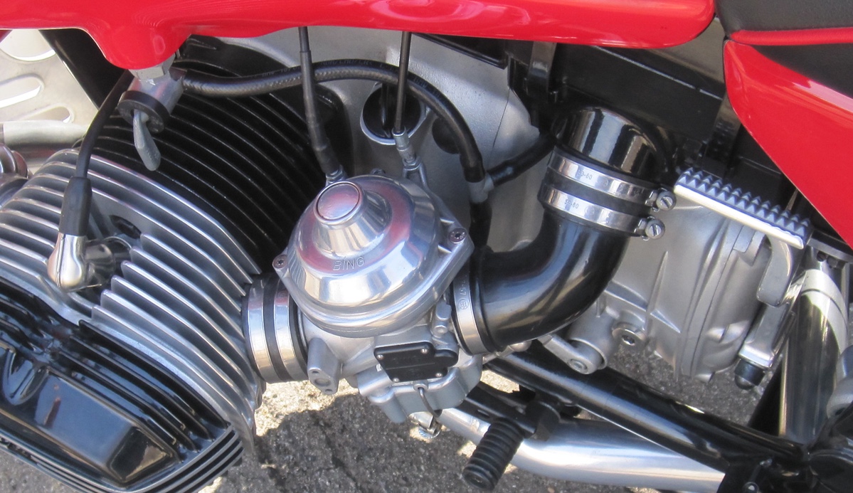

- Untitled.jpeg (309.65 KiB) Viewed 1030 times
- Zombie Master
- Posts: 8828
Re: Pre-Restoration Questions
As far as engine cosmetics go...I'm not qualified to comment. :lol
Have you no shame?

GSPD....How can you ride around with an engine looking like that. I would be ashamed.
Anyway, thanks for everyone's responses so far.
