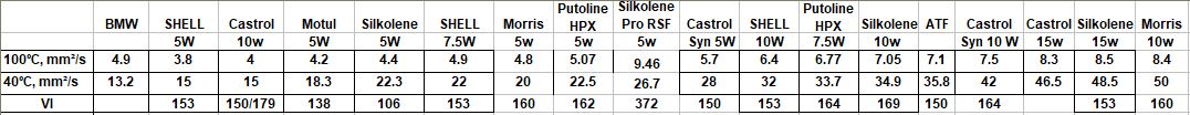

Fork oil designations refer to the nominal viscosity at 100 Deg C which is a bit of nonsense, at least for road bikes as the oil runs much cooler than that. Fork oil manufacturers data sheets will also give you the viscosity at 40 Deg C which is a much better means of comparison between oils. Once you have found a oil that works for you, either keep using it or find another oil with similar viscosity at 40 C. Noting Robs comments on the meaning of W my view is that it is used incorrectly on forks oils and most certainly does not indicate the viscosity at 0 deg C. For example the viscosity of the Castrol Syn 5W is approx. 200 cSt at 0 Deg C
Here's a table of oils I found for sale some years ago ordered in viscosity at 40 C from the thinnest original BMW recommendation upwards. For my forks I a viscosity of 20 cSt at 40 c was about right.
Fork Oil.JPG (48.47 KiB) Viewed 2086 times

We don't disagree that W is used inappropriately in most fork oils but most manufacturers do still use it in there designation and even in the few cases where they don't, the outlet selling the product often does.
There is clear correlation that the designated number refers to the approximate oil viscosity at 100 Deg C. I don't believe it's a just an arbitrary number without reference to a unit of measurement. Inappropriate as it is to rate fork oil in this way I believe they simply followed the practice for motor oil.
The bottom line is that the marketing of fork oil is a confusing mess such that the only sensible thing to do is ignore the designation and look at the manufacturers data sheet.
