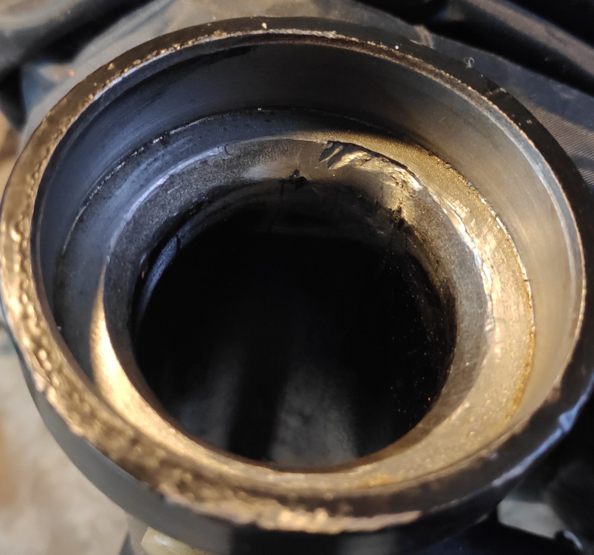

just finished to disassemble the outer rings of steer bearings from the bike frame, it's been a journey to hell!!
I was originally intending to make myself a tool like the one from Cycle Works but my friends laughed at me saying there was no need, so I convinced myself that I was too fussy...
Tried with their slightly curved steel bars shaped like chisels beating from underneath the rings, but there is no space or slot to place the tool in and beat with the hammer so the result is this:
- IMG_20230211_170517.jpg (1.1 MiB) Viewed 1699 times
now I have to lower all the metal burrs that I raised by tapping on the inner edge...
the question is:
Do you think it would be useful to create two slots for a future disassembly?
like this
- IMG_20230211_171132.jpg (1.12 MiB) Viewed 1699 times

There is a simple trick to get the head ourer bearings out (and swing arm bearings... any taper roller bearings really). Simply use a mig welder and run a bead of weld round the bearing face. The bearing will the be loose in the housing so that it can be removed with the minimum of persuasion. Often it will just lift out. I've done it numerous times and it always works well. No damage to the housing or modifications.
great advice Rob, I'll keep it in mind for next time, tanks
