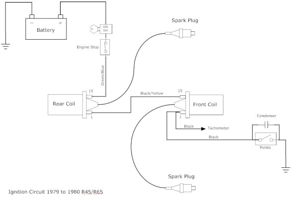

A full circuit diagram can be daunting to follow if you are not used to doing so. For fault finding at the side of the road I produced a simple diagram of just the ignition circuit. It's not specifically for a 78 R100 but it should be the same in principle as you should also have points ignition and two 6v coils albeit mounted in different locations. I would expect BMW to have used the same wire colors. If that is so there should be a Green/Blue wire from the stop switch or kill switch to terminal 15 on one of the coils. that will be the first wire to check for a short circuit. Of course this will all depend on the ignition system and wire colors being stock. Even if it isn't stock the ignition circuit is really very simple when viewed in isolation like this.

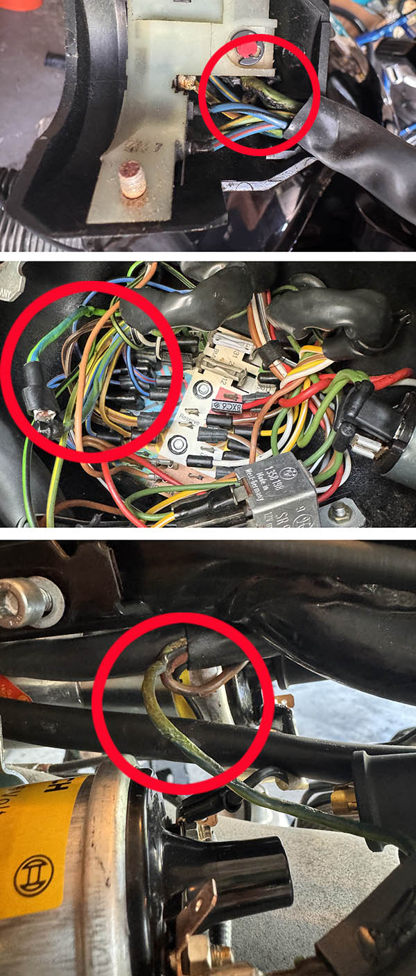

Attached is photo from today. The wire is fried from the kill switch, thru the headlight, to the coil. I assume I will have to run a new wire thru the entire run. No fun, but manageable.
My real question is, is this the culprit or a casualty from another short? I looked at everything from the kill switch thru to tail light (per green line in wire diagram below) and didn't see anything that looked exposed that could cause short. Just trying to be cautious. Would greatly appreciate any thoughts here.

I would suggest that the fault is unlikely to be at the switch itself... not impossible but unlikely. The symptoms appear at the switch because that is the 'pinch point' for the current. The fact that the wiring is melted suggests that the problem is elsewhere.
The fact that the wiring isn't stock is a problem because it makes it difficult to interpret the evidence given... however... looking at the third image, I would think it likely that the melted wire is the wire from the kill switch to the coil. Assuming this to be correct, the black wire between the two coils seems to be OK. This would seem to indicate that the short circuit is either a faulty coil with a direct short to ground or something else connected to the same terminal on the coil. The stock wiring diagram shows nothing else connected at the coil terminal.
OK, second assumption is that the machine has stock 'points' ignition. This is important because many, even most, aftermarket electronic ignition systems draw power from the positve coil terminal. I.e. the terminal with the melted wire. That being said, it's also a fairly common place to pick up a supply for a number of other accessories.
OK again... 1) if the melted wire goes to the coil, there is not obvious short circuit (i.e. bare wires and signs of burning) before it gets there, and if there is nothing else connected to the same terminal, I would suggest that the fault is highly likely to be a faulty coil with an internal short to the case... Not very common but not unheard of.
2) if there is a second wire to the terminal on the coil and this shows no signs of overheating, then the fault is still probably at the coil...
3) If there is a second wire and this shows signs of overheating, then the issue is going to be with whatever is connected via that wire... can't go any further than that.
Whatever the cause, you are going to have to replace that wire before you try any trouble shooting.
