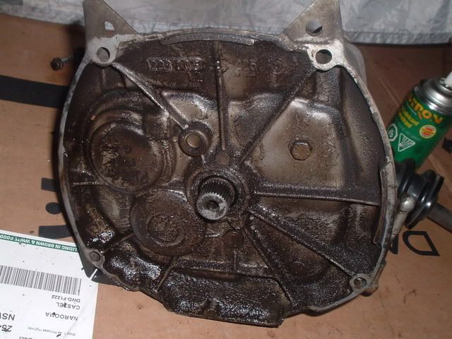

Thanks heaps for the input, I removed the gearbox yesterday.
It is very dirty in there,

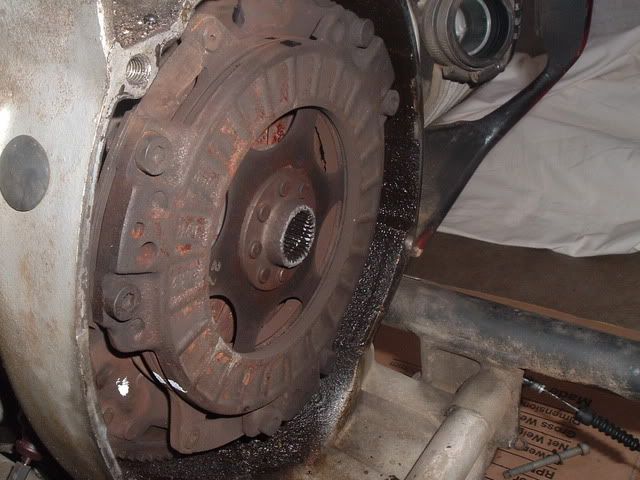

Then I got the clutch out this morning, it took a bit due to an allen head being rounded out, new bolts I guess,

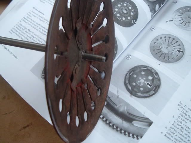

A big question is should the pushrod go through the pressure plate like this?
And, is the pushrod reuseable if I get a new pressure plate?

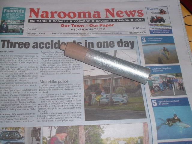

Re the gearbo, I'm still uneasy though it does'nt sound to bad. I've made this clutch tool out of
hardwood, hope it works.

The clutch friction plate spline looks a bit or'nery Bob!
That pushrod looks a little different to my 81, but if your clutch was working ok, it must be right........

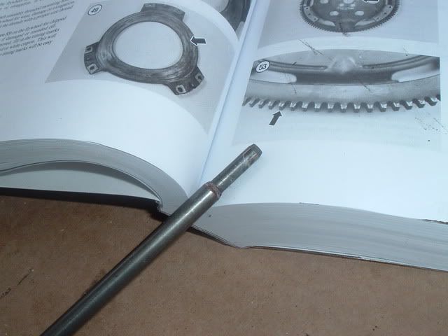

Re: Clutch Removal R80 Mono
here's the proper tool. you'll nned the pin to be 6mm diameter and long enough to pass through the spring into the center of the flywheel adapter thingie.

G'day Bob. Looks like you need a new engine rear main seal and a gearbox input shaft seal. For clutch parts check out Motobins prices - you'll get them at about half Munich's price, delivered. Give the ol' R80 a pat from me.
