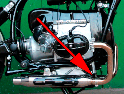

I'm doing my first build on a '78 R100/7 and will be adding exhaust like this. Wondering if anyone can give me the outer measurement of the stock exhaust where I have the arrow.
Image of exhaust
Image of exhaust

38mm on most or 40mm for some of the big valve bikes.
