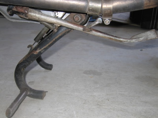

picturethis wrote:....Anyone else have this issue? Assume it has something to do with mechanism being worn? Any pointers to remedy?

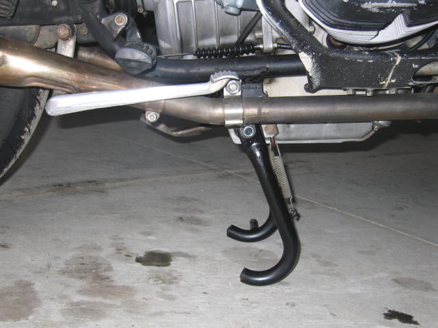

When the stand tips or contact stops on the frame wear the bike goes too far over centre on the stand and although it doesn't seem logical, that makes it feel as if it's hard to put on the stand. They can be repaired by building up with weld and grinding to fit.
If your stand sits at an angle like this then it's badly worn:
Worn Stand.jpg (58.77 KiB) Viewed 6508 times
After repair it should be much nearer vertical like this:
Repaired Stand .jpg (92.91 KiB) Viewed 6508 times

The 83 c/stand should be 240mm from the centre of the pivot hole to the bottom of the feet. The 81 c/stand is 250mm.
The 10mm difference was an 'upgrade' from the 81, to make it easier to use.
Repairing the stand as in the pics below won't make it easier to get up on the stand, but it will make it a hell of a lot easier to get off the stand.
The Reynold ride off stand used the 'shorter leg length' concept to make it easy to use.
Repairing the stand is not so easy to do if you can't weld. It takes some accurate work to do properly.
