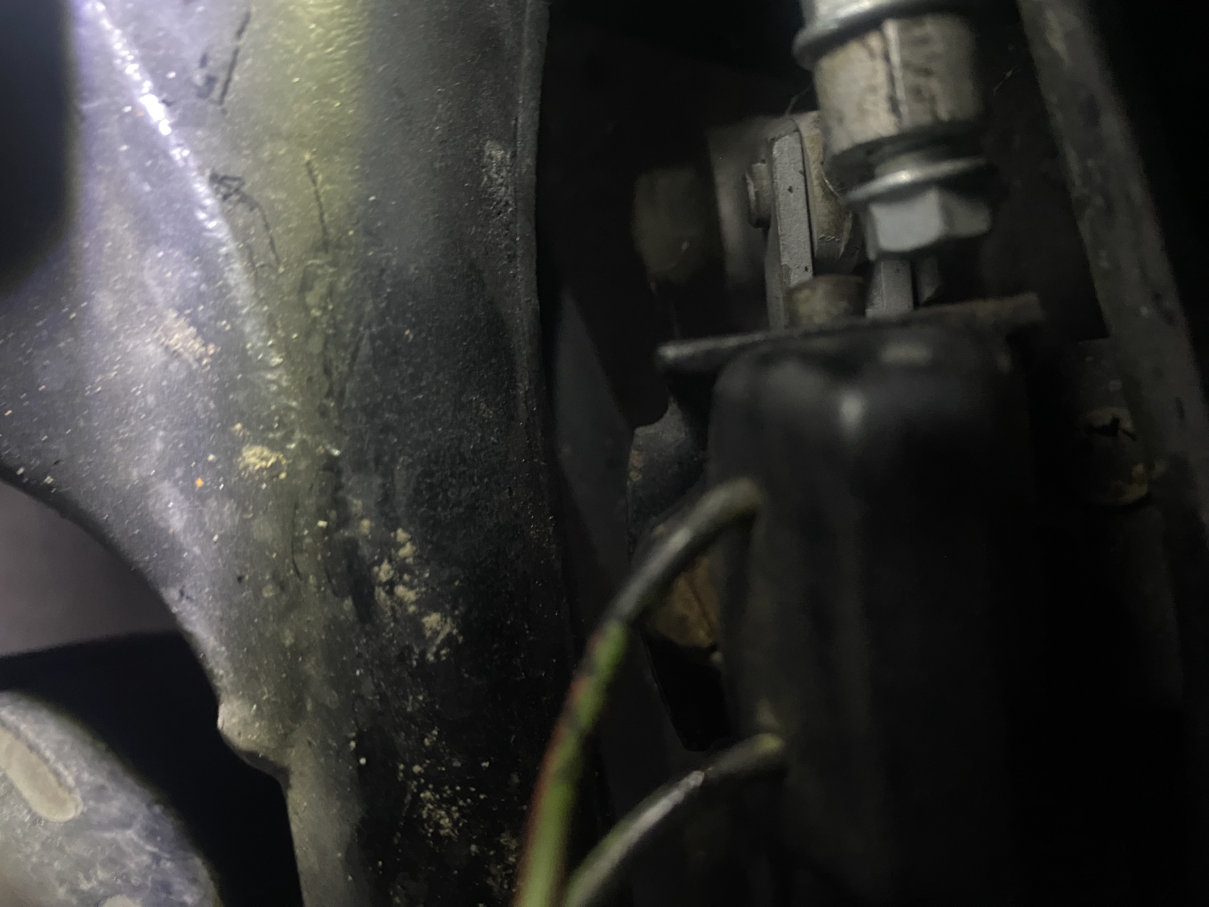

My 1979 R100Rs, cant align rear brake pedal with the switch activator, so brake light stays on always, is there any way to adjust the brake pedal mechanism ? The switch has a fixed bracket , no adjustment
Re: rear brake- light not activating
eriojas wrote: Fri Apr 04, 2025 9:56 pm My 1979 R100Rs, cant align rear brake pedal with the switch activator, so brake light stays on always, is there any way to adjust the brake pedal mechanism ? The switch has a fixed bracket , no adjustment
Willcommen eriojas. Have you got all the spacers/fasteners? And in the correct location?
