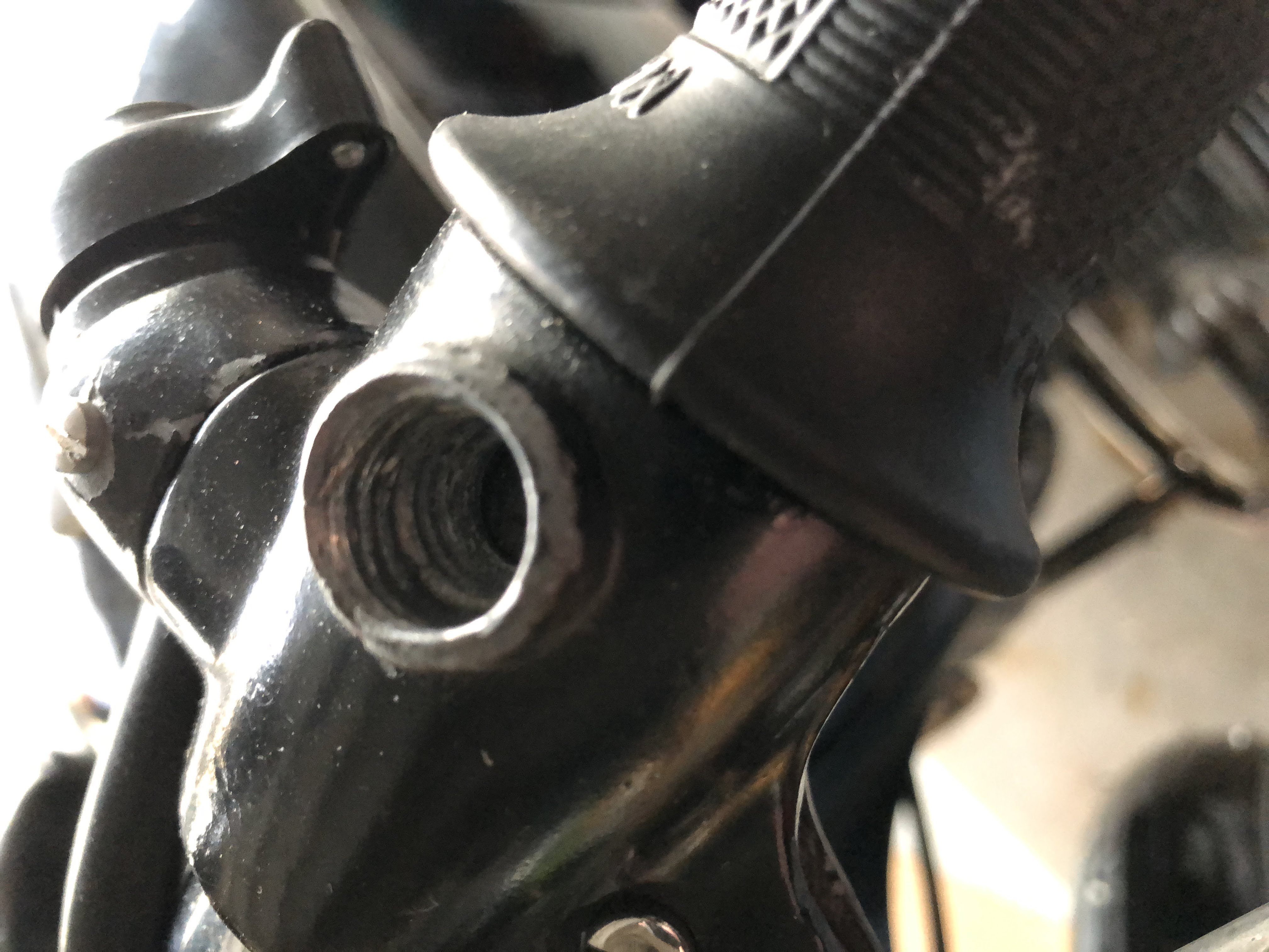

Hmmm. I'll have to check out the timesert and the zoro ez lock ( I am assuming because it has a "l" at the end that the zoro it is left threaded). It looks like you drill the hole with the correct size drill bit and then pound/drive in the insert in - no need to actually tap/thread the hole, right? If worse comes to worse, I will fall back on the JBWeld - I do appreciate that input as well. I forgot to take a few pics yesterday. Will try to remember today just so you guys and see what the deal is visually. Thanks!

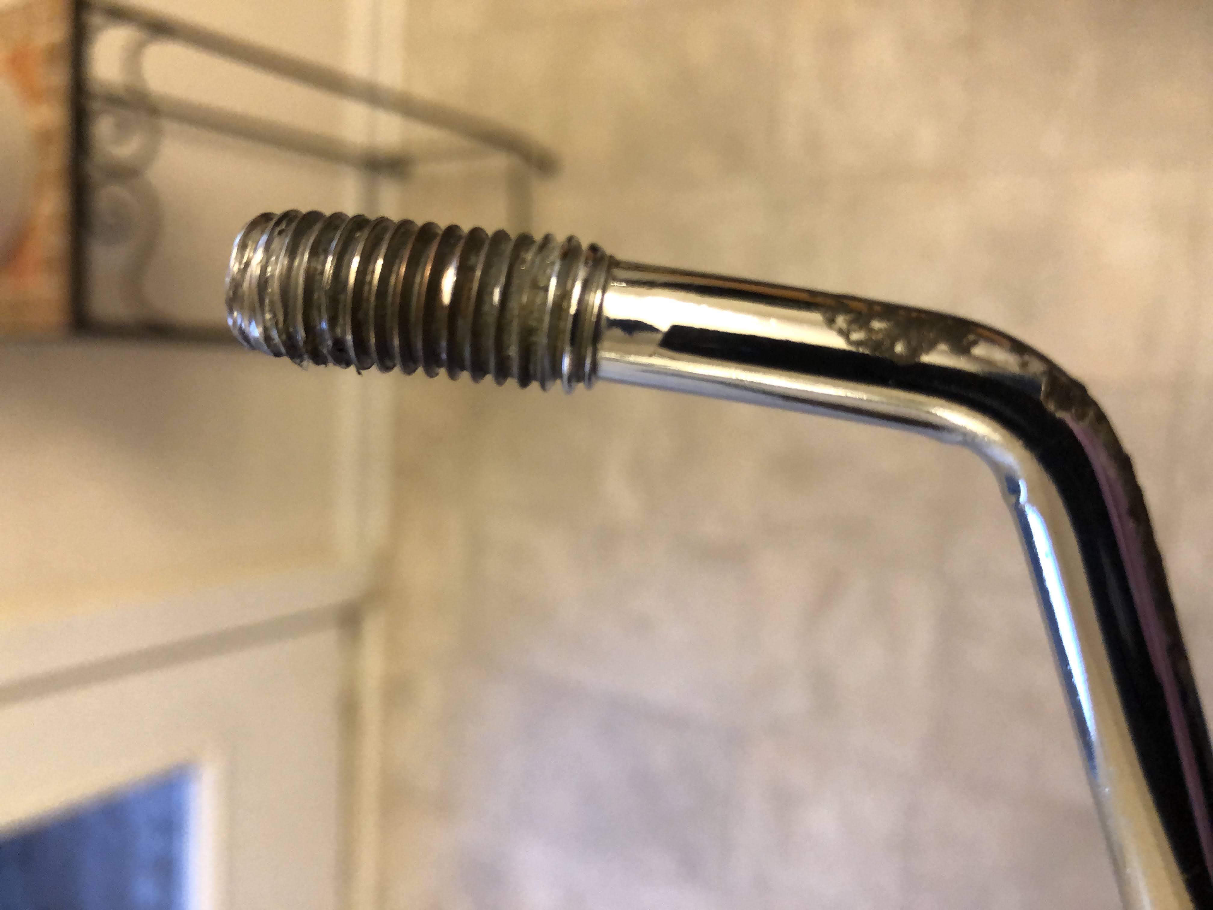

Here are a couple pics...
