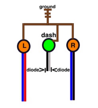

This will fix it
Power to left turn signal is BLUE/RED
Power to right turn signal is BLUE/BLACK
Power to dash indicator is BLACK/WHITE
Do a bit of tracing to determine why the BLACK/WHITE always has power.
Maybe something is shorted or wrongly connected.
If there is actually a faulty circuit inside the relay and you don't want to replace the relay, connect the BLACK/WHITE to the flasher feeds.
You'll need two 5W diodes (basically a one-way valve) so the left side doesn't feed back to the right side and vice-versa.
These diodes can be had for pennies at any electronics store.
This will work, but wait to see if RobF can devise a simpler solution.

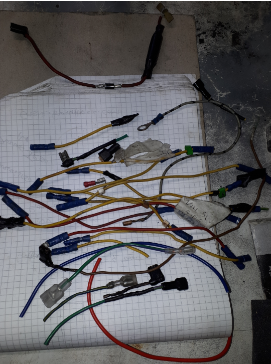

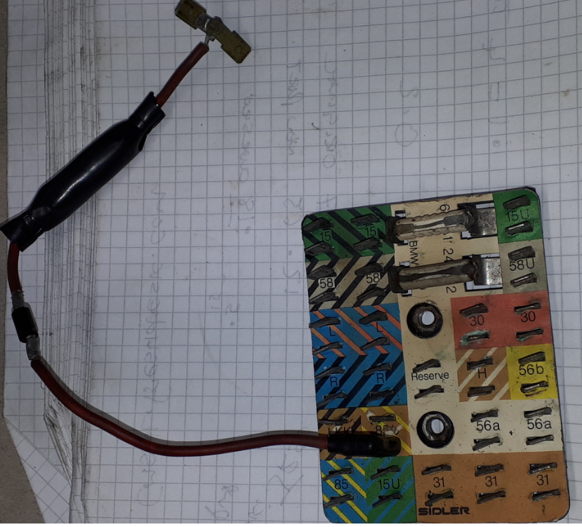

changing the subject slightly but sticking with diodes , i came across this fix in the headlamp shell to bypass the diode on the fuse/connector board in headlamp should the diode on the board go , you can see that a jumper cable has been made up with diode soldered in line and a double spade at one end ( think it was the neutral switch side rather than the starter switch side due to diode direction ) . I will be keeping this bypass cable for temp repair on the roadside.
As you can see one of the previous owners loved yellow cable and crimped connectors which i have removed and made good now in headlamp .

As I'm reading the diagram, the right is linked to one side of the repeater and the left is linked to the other. This won't work for two reasons... 1) one side of the repeater is hard wired to ground inside the instrument cluster and 2) each diode would block the current flowing through the other. The way to do it is to take the two diodes and link the anodes together (the anode is the end of the diode with the white or silver band). The linked anodes are then connected to the wire to the repeater. The cathodes (i.e. the other ends of the dioes) are linked to the right and left indicators respectively. Very simple and just a 'dongle' that fits inside the headlamp shell. As I said, I have a diagram... but not on this computor.
Or perhaps I'm misreading the diagram and it actually shows what I am saying...
Question for Rob
I omitted the pre-existing ground circuit in my earlier diagram.
The 2 lines going into the dash indicator are one wire. (my way of drawing one Black/White wire)
I thought I drew the diodes to show that power can flow in to the dash indicator but not out of it.
Does this make more sense?
Activating either flasher will light the dash indicator, no?

My misreading, I was seeing the thick and the thin black lines as seperate wires. With the earth clarification, the diagram is exactly what I was describing.gspd wrote: ↑Sat Jun 26, 2021 9:55 am I omitted the pre-existing ground circuit in my earlier diagram.
