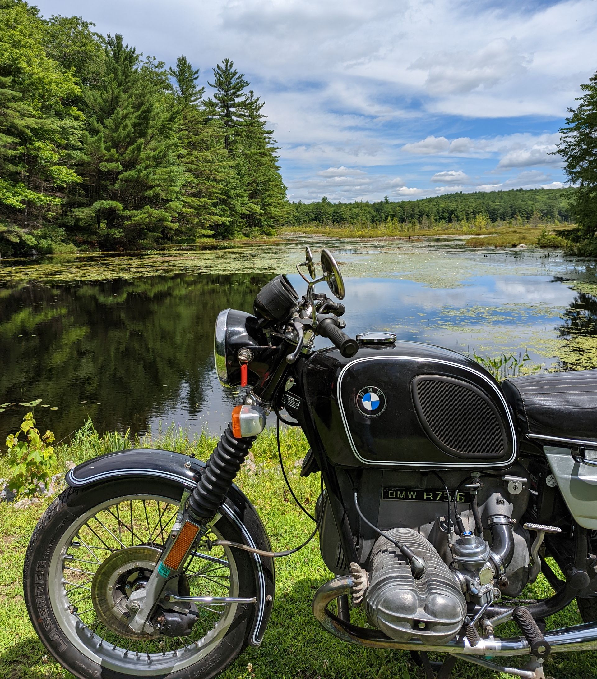

Just picked up my first airhead: '74 R75/6. She's a rider in really good shape.
1. The starter turns over slowly, charging system works good, lights are bright. Any ideas?
2. She runs rich. Thought I would check the Dyna III timing, valve adjustment
And carb settings...in that order. Thoughts?
3. Had the spokes and wheel balance checked. Still have an intermittent wobble
At 30~40 mph. Maybe next year I'll change tires. I don't have a steering damper.
The BMW parts photo and list for the factory unit is...whoa! Are there alternatives?
Thanks for any input.

Do you have pix? We like them.

This summer just goes on and on...
That's for the great info and tips!
- PXL_20220726_153600556~2.jpg (957.01 KiB) Viewed 2344 times
