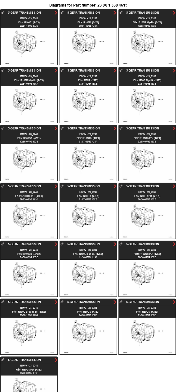

fwiw a search with pn 23 00 1 338 461 on maxbmw fiche doesn't include 80-84 in the list of compatibilities.
Screenshot 2022-09-03 at 21-51-47 BMW Motorcycle Parts Search for parts.png (129.12 KiB) Viewed 2103 times

My search above looked at the later pn from the R100gs
This search is from the early R80g/s. from www.realoem.com because it gives a list instead of thumbnails.
fwiw...unsure if it helps though. The fiche has it's own idiosyncracies. :roll:
