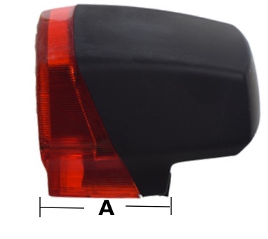

Can somebody please tell me the exact width and height of this TAIL LIGHT LENS ?
I also need depth 'A' in pic.
I'm pondering a custom install and want to be sure it will fit as I want it.

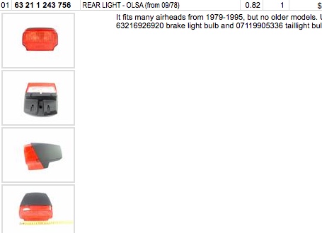

It's for a late(r) model airhead. BMW part # 63 21 1 243 756 is the complete assembly.
Thank you.

Just been out to the garage and measured mine with a digital caliper. Width and height were measured at their maximum points on the lens as the surfaces are all tapered in both directions. God it's cold out there.
Width 154.5 mm
Height 99.7 mm
A 78mm
Re: Tail light lens size
thank you!
