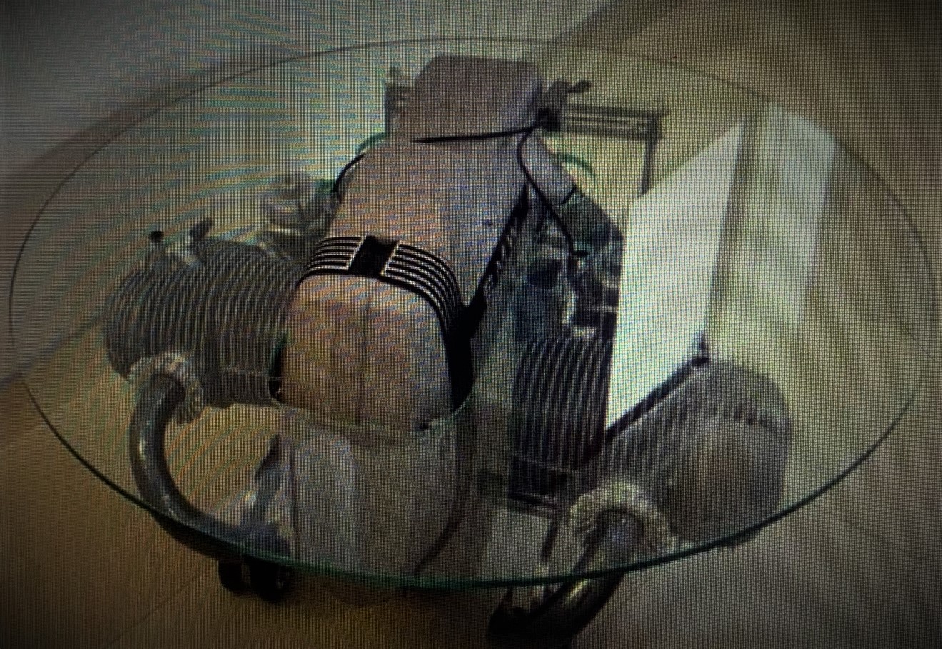

Bugger, it looks kaput. I won't link to the crank regrind thread. ;)
There is an option or two...
coffee table.jpg (477.1 KiB) Viewed 1041 times
The learning aspect is good though. Disassembly and re-assembly. :idea: :idea: :idea: It might be a useful tool for someone to strip and sort as a dry run before doing their own in earnest? Have you got the tools for the main bearing etc? Maybe the local beemer club?
I'm seeing an occasional rainy Saturday arvo tutorial for an interested party. They bring the beer o'course.
Doing the same thing for a transmission would be good too.
