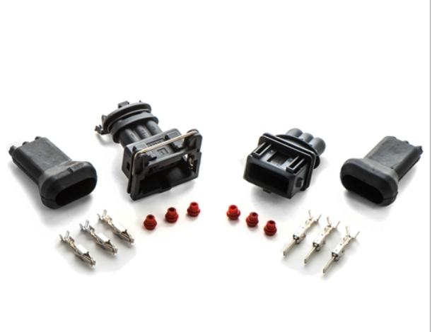

The connector bean can end, or the connector ICU end? I think you can buy those connectors now ...maybe from EME?
61121244176 is ICU end...
Wire ignition coil
BEAN can loom repair kit.
https://www.euromotoelectrics.com/produ ... 088set.htm

Thanks Steve. That's exactly what I need rather than getting the whole harness. Repair kit ordered.

That's not actually a bad price but, if you just need one of the connectors (or parts) for a repair you can order them, individually. They are called 'Junior Power Timer Connectors' manufactured by 'TE Connectivity' and a search on the net will find them. Male connectors (i.e. bean can side) are more difficult to find than Female (EMU side) but you can find them if you look.
This UK based company shows stock for the female side (complete with terminals which are sometimes listed seperately) at £UK 4.20 but I would expect them to be available in most territorries.

Thanks Rob. I wish I could say I only need one side, but when I bugger something up--I really bugger it up. I need both connectors.
