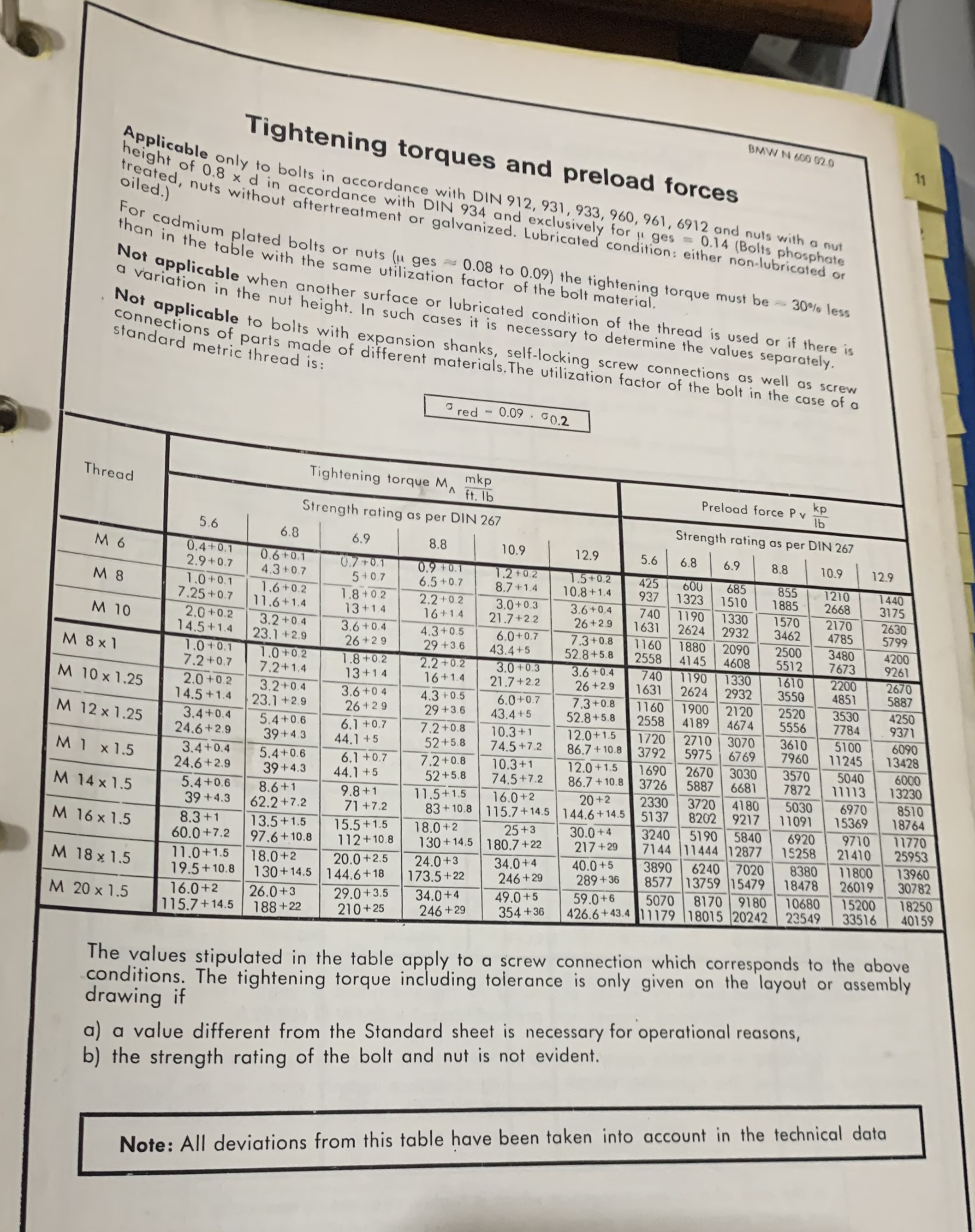

#13? M8x22 8.8 strength from the factory twin shock manual. The manuals should have a torque spec page in the first chapter?

BMW and most manuals only specify the torque for a specific fastener if it differs from the standard torque for that particular thread size. I don't know which edition of Clymer you are using but the table of standard torques is on page 22 in mine (1997 printing).

Thanks Steve for that table; however, I'm not sure how to interpret/read the table.
An M8 8.8 bolt/nut shows this
2.2 + 0.2
16 + 1.4
What number do you use? Sorry, but this is above my knowledge. Time to go back to school--so to speak.

Jeff in W.C. wrote: Wed Jan 25, 2023 2:16 pm An M8 8.8 bolt/nut shows this
2.2 + 0.2
16 + 1.4
2.2 is for kilopondmeter which converts to 16 ft-lbs. Top line is mkp and bottom line is ft-lbs.

Kurt in S.A. wrote: Wed Jan 25, 2023 2:52 pm
2.2 + 0.2
16 + 1.4
Thanks Kurt. Sorry, but I have another basic question. Do you add the 16 and 1.4 for a total of 17.4?
Out of curiosity, what is the 1.4 for?
P.S. I had to Google kilopondmeter. This stuff is outside of my current knowledge base, but it's always cool learning new stuff.

I think the 1.4 is a not to exceed number on top of the 16 ft-lbs. Sometimes you see +/- numbers to indicate a range.
