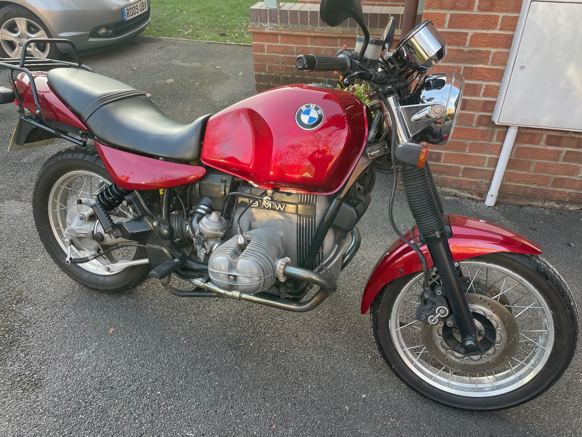

Hello,
I’ve just bought a 1995 R100R Mystic with a genuine 25,900 miles on the clock.
It’s only covered about 1500 of those miles since 2006. It’s in good condition overall (on the outside a least) but work to do before my first ride.
Both tyres have cracked sidewalls and low tread: a Michelin Macadam on the rear and a Continental TK 11 on the front.
Does anyone have any recommendations for replacements?
Thanks in advance!
Endo
