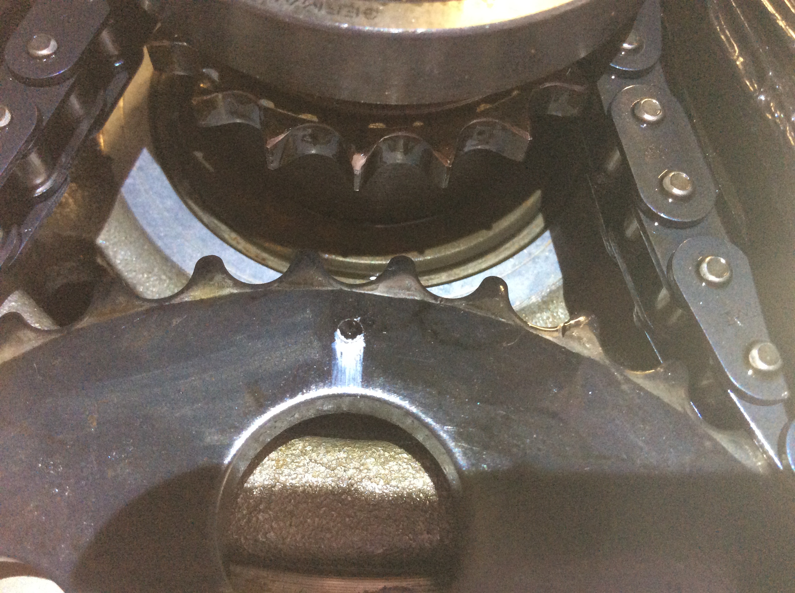

Hi All, thanks for your input. As you say it does seem to point towards an issue with the advance mech. I decided anyway to have a look at the alignment of the crank/ cam sprockets any they are fine , plus the cam sprocket wear which does’nt look too bad. I stripped down the bean can again and could not find any evidence of the advance mech sticking. On checking it I cannot see any way I of assembled it incorrectly and have cross checked it with pics on web sites. I do have another beancan but was similar when fitted . .I have been wondering now if its something to do timing light or the process as you have said Barry. Will have to get the gaskets and re assemble the timing case , and get back to you as i would appreciate some help.
Timing marks on sprockets .
