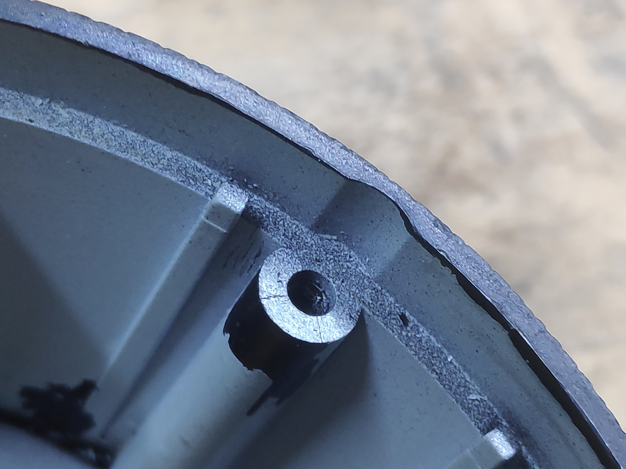

Restoring my ride I have to face a new challenge:
repair the internal columns of the instruments cluster , those that serve as housing for the 3x15 self threading screws. They are all cracked :(
First of all I would like to ask what type of plastic the cluster is done in your opinion, cause I need to reinforce the columns with
a bi-component glue but looking around I see there are a lot of different types
and second question is:
can I put M3 threaded copper inserts instead self threading screws? Have any of you already did it?
thank you all!

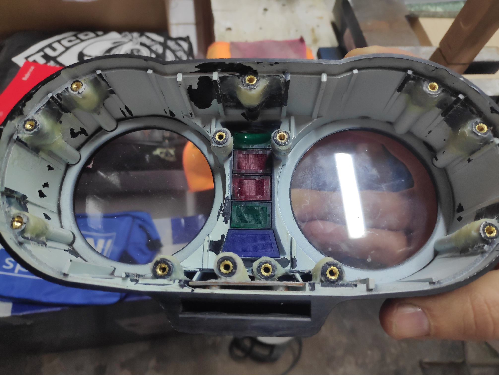

Finally I've fixed the columns of my istrument cluster, I used threaded M3 inserts, heat inserted using the tip of a circuit welder
before I prepared the holes with increasing diameter drill bits (from 2mm to 4)
after the inserts I reinforced every single column with epoxy 2k glue mixed with crumbled scissors cutted glass fibre
The photo is before I refined all with the dremel:
Glue seems to have a good superficial hardness and tenacity at the same time,
only time will give us a response
