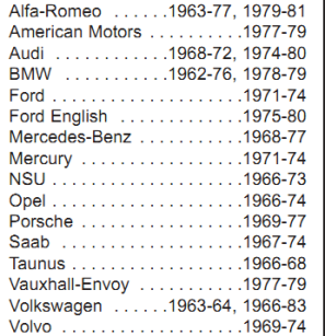

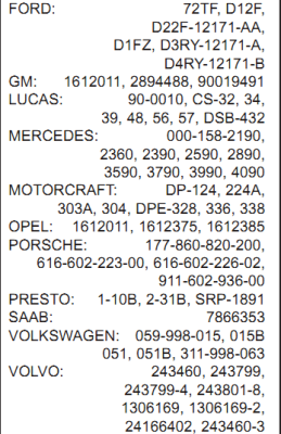

It's a shame such a simple component as points are hard to obtain in decent quality. I still have a spare new set of BMW supplied points that must be well excess of 15 years old which I think is before the Chinese shenanigans. With the aid of an pointers booster, they should outlast me.
For those with points in a can there are allegedly many alternatives available which is perhaps not so surprising given the can was developed from an existing automotive distributor. Here is what is supposed to fit.
