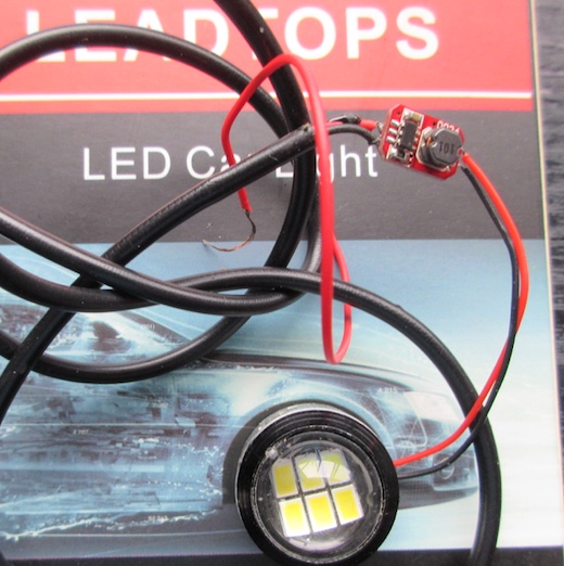

FYI - These LEDs come with a tiny device that makes them bi-directional.Rob Frankham wrote: ↑Sun Mar 03, 2024 7:22 am I've been waiting for someone to bring out a bi-directional LED 'bulb' but haven't seen one yet... I've even looked at creating my own but space considerations make it difficult.
- Untitled.jpeg (105.75 KiB) Viewed 2181 times

Thanks for that... that's not really what I mean. What I am talking about is a simple replacement for a panel bulb (wedge fitting in the case of a BMW instrument illumination lanp) that will work bi directionally without modification to the wiring... Could easily be produced on a production line, all you would need to do is fit a bridge rectifier in the bulb between the socket and the lumiere... very fiddly, however, as a one off. Sadly probably not sufficient market to make it worthwhile.gspd wrote: ↑Sun Mar 03, 2024 10:57 amFYI - These LEDs come with a tiny device that makes them bi-directional.Rob Frankham wrote: ↑Sun Mar 03, 2024 7:22 am I've been waiting for someone to bring out a bi-directional LED 'bulb' but haven't seen one yet... I've even looked at creating my own but space considerations make it difficult.
