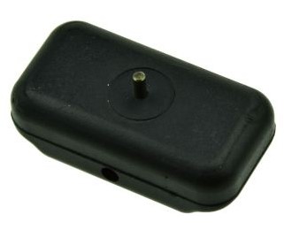

Not to throw a wrench into the discussion I have so-called ethanol resistant floats, two per bowl (see image). The float bowl is black so aftermarket. I took the bowl off and and measured 21mm of fuel WITH the floats in the bowl. The bowl with the floats was nearly filled to the top. Does anyone have experience with this system? If so, does this sound about right for fuel level?
Kevin
Kevin
