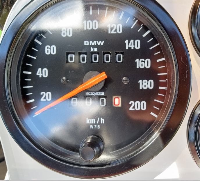

Odometer rolled over again
Love when this happens, makes it feel like a new bike again.

It really does look like a brand new bike! How many times has it rolled over now?

The odometer has flipped-over 6 times. The whole bike, only twice.Steve in Golden wrote: ↑Sat Jul 06, 2024 10:31 am It really does look like a brand new bike! How many times has it rolled over now?

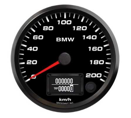

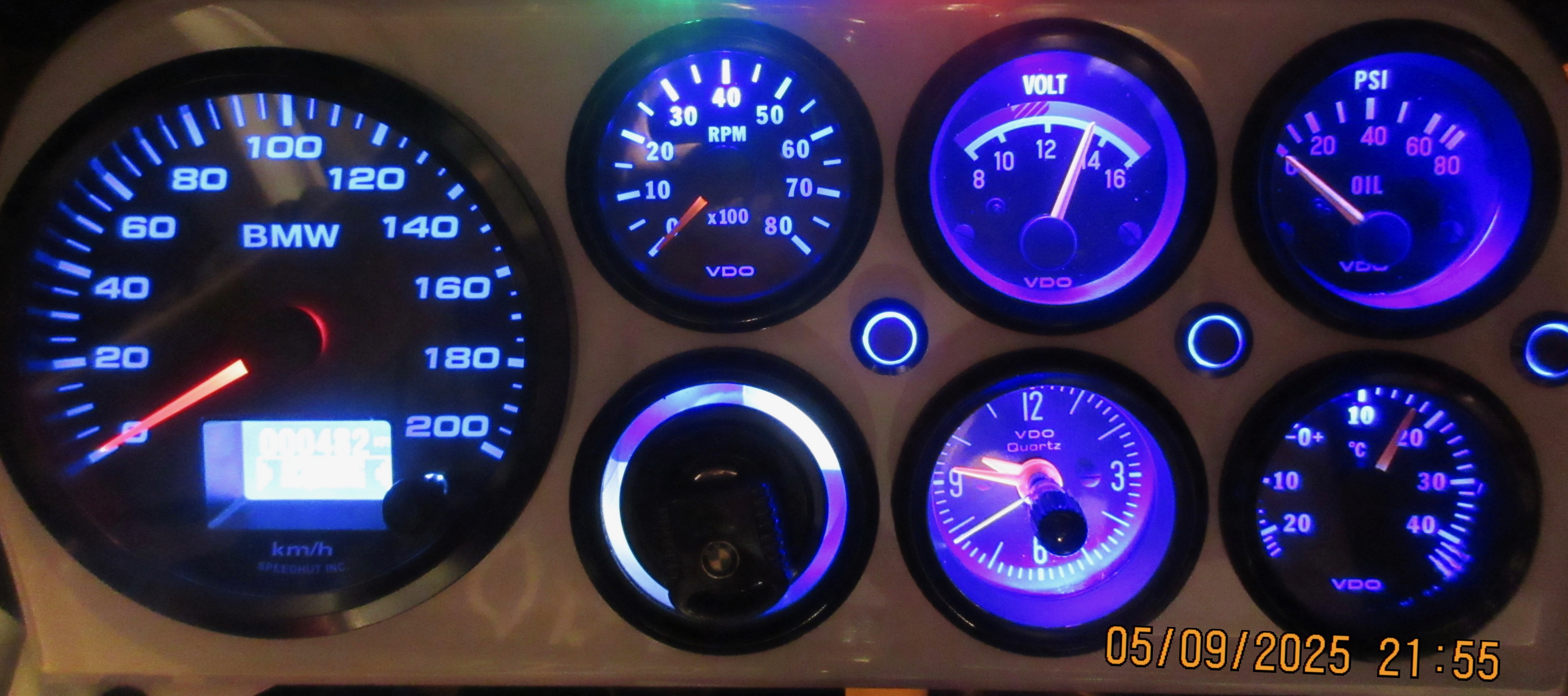

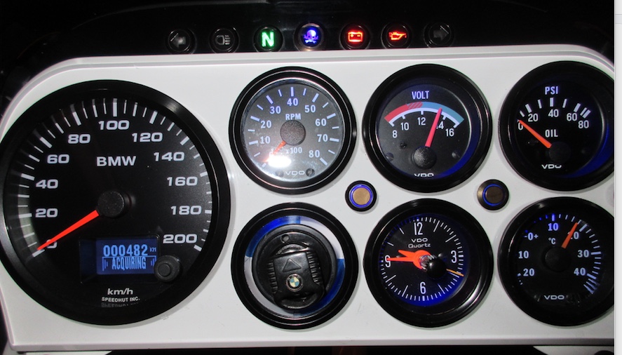

So, my old speedo was now up around 20,000km and the needle started bouncing around (again).
Took it apart, fixed the bouncing needle (again) and I tried to calibrate it as best I could with strategic needle placement.
I did some speed checking with a temporary GPS speedo hooked up.
It read dead on at 105km/h, but read 60km/h at actual 52km/h (8 over), and at an actual 148 km/h it read only 140 km/h (8 under). This was pissing me off. It was not a new problem, but something I had learned to compensate for over the decades I've owned my bike. The odometer was always pretty much dead on throughout its life.
I remembered respected forum member Airbear was quite pleased with his Speedhut unit, so I decided not to waste anymore time with my antiquated analog POS and forked over a small fortune for a new digital Speedhut GPS speedometer.
So far, I LOVE IT! Totally accurate at any speed, super smooth and steady needle movements, and a ton of other features to toggle through such as altitude display, direction display, 0-60 timer, 1/4 mile timer, gps time clock, 45 second start up time from cold, much less if restarting when stopped for less than 4 hours, etc.
I now have the extra digit so it won't start over at 0 every 100,000km the way the stock one did.
I thought I'd miss the analog odometer digits rolling over, but I hardly even notice that.
The lifetime warranty clinched the deal.
Other bonuses : Its blue glow at night perfectly matches my other gauges and no more stupid speedo cable to deal with.
