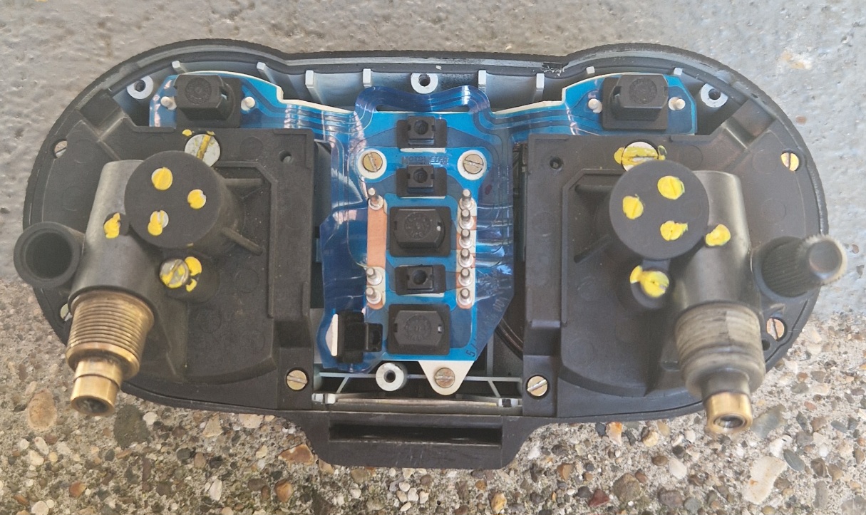

Hi.
Also an image of the dash internals, it wouldn't let me add another to the previous post. It looks in good order, i can't see any faults.
Cheers
Gary

- Dash internals
- 20240809_081637.jpg (326.62 KiB) Viewed 1505 times
Re: Charging issue
As we look at the image above i identified the top left pin as 12v supply for.the warning lights and on the right,
3rd from top is gen lamp
5th is oil.
I used the corresponding holes in the connector for the tests in previous images
5th is oil.
