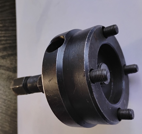

I was working on a trans from an R90S. Trying to replace the rear main seal. Bought the output flange puller from CycleWorks (was Ed Korn). Attached the puller. Put lots of tension on it, but the flange didn't budge. I decided (badly) to hit the puller in line with the shaft (not to the side), hoping it would pop, lightly at first, but then with increasing force. Instead of popping the flange, it drove the shaft slightly further into the case, damaging that plate. The trans didn't shift properly. Sometimes could get neutral, but when it got into gear, would lock as if 2 gears would engage simultaneously. I'm assuming a lot of end-play in the output shaft.
Took the trans to Bob's BMW in Maryland. They took the cover off and looked at it for several hours without finding anything. When they brought it out to me, I showed them how the multiple gears were engaged at the same time. They said it was all the time they could spend on it that day. Left it there. Came back the next week to pick up the trans. That "protection plate" was the only part that was damaged, but they replaced a couple bearings and the seals for good measure.
So that's my experience with it. I screwed up. Bob's fixed it. My hitting the puller, driving the shaft further forward in the case damaged the "protection plate" and caused the shifting problem.
Re: Replaced clutch now tranny won't shift into gear
Not sure which type of puller you used and exactly what happened, but maybe your puller was not up to the job. I've literally removed hundreds of these flanges with my BMW OE tool and never had to use any type of impact force whatsoever. They always just pop off with minimal torque. Hitting the puller sideways would be a mistake, could bend or distort the flange. In your particular case I would have suggested you preload the puller as much as possible and then heat the flange with a torch. That would have popped it off. I've done that many times with success on countless other types of seized flanges.
- puller.jpeg (50.14 KiB) Viewed 47677 times
